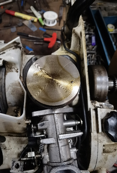

The carb bore is definitely a restriction on the 395 with the carbs on them. That’s one saw that seems to benefit from a little carb work.
huskyboy
Sorta a husqvarna guy...
4:39 AM
1352
May 30, 2016
10,026
43,492
Ct
Uppers need the roof flattened a tad more, just a educated guess. You want that pattern on the chamber to be on the piston. But how does the saw run? If she runs good I wouldn’t worry about it too much. All piston tops turn black from carbon after a while anyway, which is why wash is tricky to read. You gotta run it hard for a few tanks then read the wash... then the two stroke oil can also play a role. Some leave wash quicker than others. Interesting stuff for sure.

Wash looks neat, but im guessing your mains are slightly aimed to mid or more to ex? And traces of charge escaping slightly through the exhaust? You can clean up the carbon and run the saw hard for few cuts to make sure
Here's an example of what happens when main is aimed too much to the middle
Sent from my INE-LX2r using Tapatalk
It runs pretty good! Ive always found this “reading wash” thing interesting as well.
The mains on that 359 cylinder were aiming towards the sparkplug hole, towards the intake. But they could have gone a little further and maybe a little flatter too
