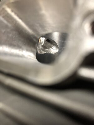

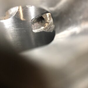

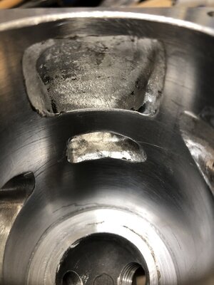

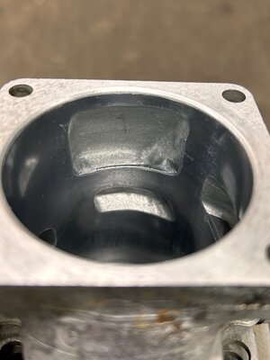

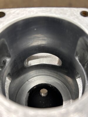

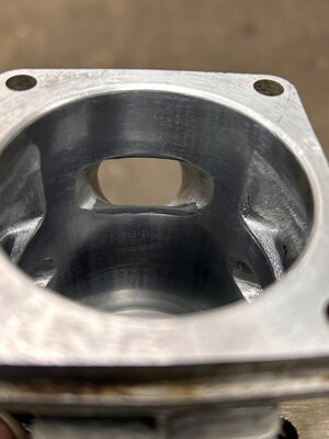

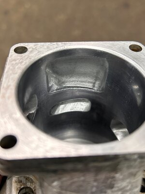

Did some more work on the uppers and they are way better than they were before and I've figured out a lot from the advice given especially from the chief cook and bottle washer... I'm not sure if I can get this particular cylinder looking much better but it's been a great experience and if I end up doing any more saws I feel like I have the confidence that it will be better than this one. Confidence can be a double edged sword but I will approach any future project carefully. Thanks all for the feedback and I'll post how it turns out once I get some run time on it (unless it turns out to be an embarrassing turd)... LOL
I got the aiming kinda where I want it... hoping that it works well... I would have preferred a smoother transition from the flatter roof intake side of the upper to the sloped roof exhaust side that opens 2* before the intake side trying to aim for the spark plug, kinda... My skills aren't there yet (if ever). Not exactly artwork, more like my version of a stick-man portrait.

MAF143 Keep the photos comming. Nothin to hide when you're asking and learning.
Back in the 70's? Before most cylinder went from having liners, to being hard plated.
We broke-arsed teenagers grabbed round files and heated a spot and bent it and quenched it as quickly as we could.
Then we could reach into a dirt bike cylinder to assault the upper transfer tops.
We even tried sandpaper wrapped longways around a toothbrush handle or whatever else, to poke into the tunnels.
I think we got more raw finger tips than we got metal shaping , in the balance.
But danged if it wasn't good Saturday & Sunday afternoon sitting under the carport, a couple of us molesting the cylinders while the grownups played cards and talked trash at us.
As for the exhaust port? A good moment back then? ... "Oh man check it out. Waldo found us a set of those 1/4 inch shank grinding stones in the GlobeMaster Tools table at the store! So go get yer drill dude."

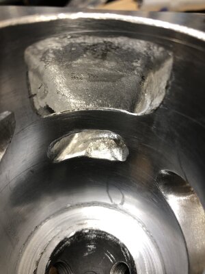

An old trick for easily flattening out the upper transfers and also squaring the corners is to use a couple stacked dremel type abrasive cutoff wheels on a straight handpiece. Doesn't get you in very deep but it's a good starting point and then when switching to the aggressive burrs lets you stay more inside the port and out of the 'danger zone' at the edges .

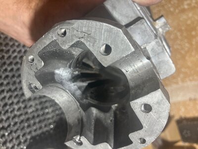

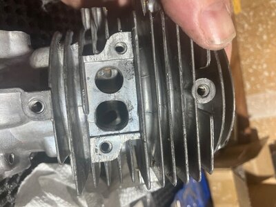

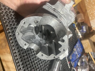

Whittled on a Mac 10-10 cylinder this morning. Brought the fingers down, enlarged the exhaust and roughed up the intake.

Muh fingers look really big
2:11 AM
360
23,593
150,869
East Jordan, MI
it'd look better if you golph bawled the intake, put in the mickey ears AND if you really want to increase performance that exhaust is hurting the potential of the power output. I know I scene it on the interwebs....
Yes. Must watch more yootoobs and facebooks to get the good stuff.
Don’t forget drilling holes in the intake skirt👍🏼
And never doing any before and after videos. That way you can just go by feel
