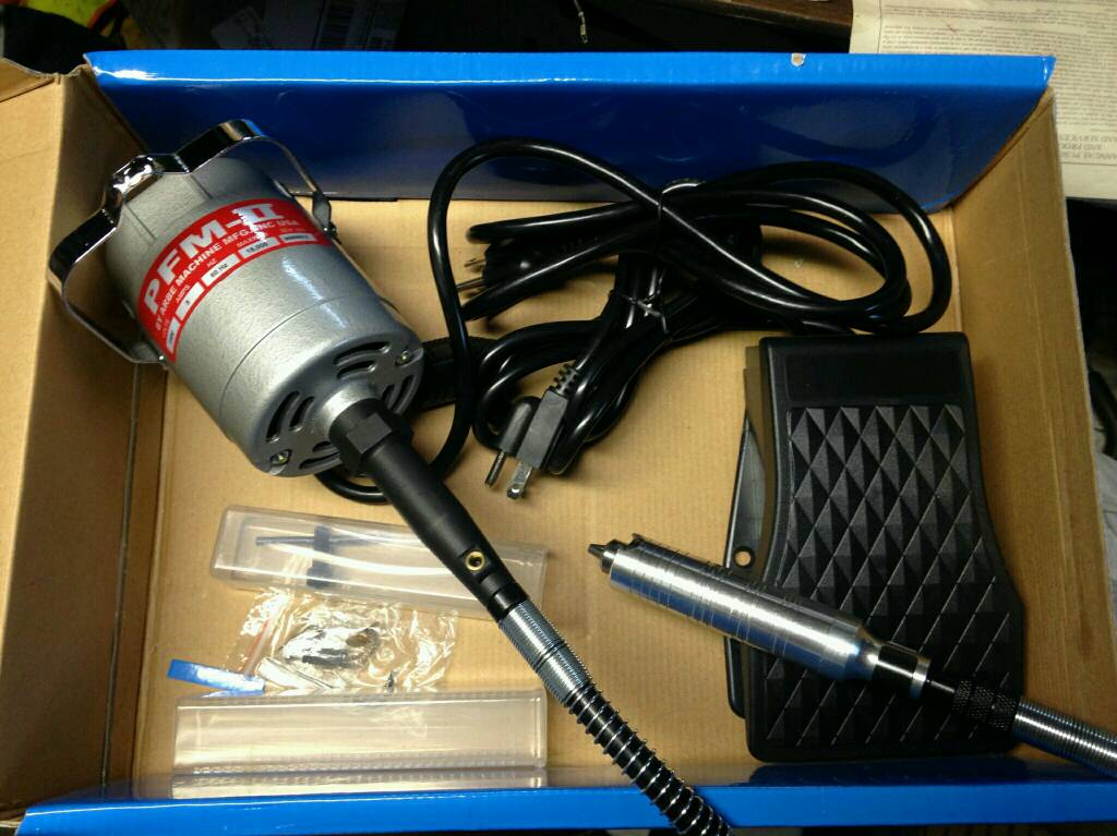

Here's the tool I bought. Still haven't had a chance to start using it. Got mine for under $100 shipped.Look at this on eBay http://www.ebay.com/itm/111608723887
