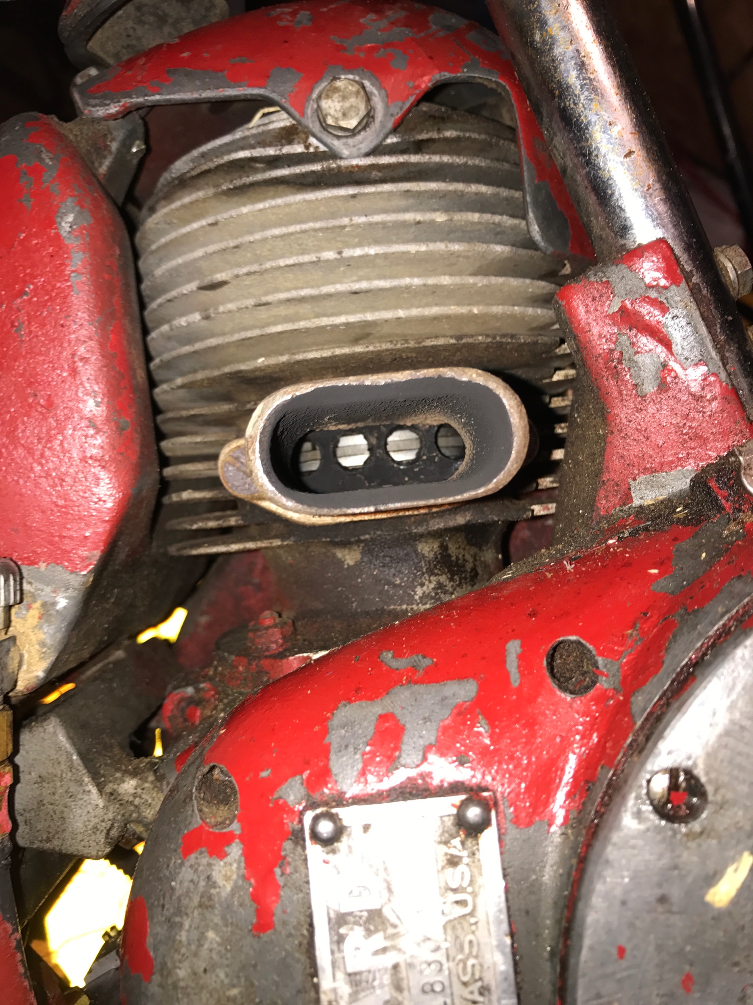

I'm being sarcastic. Ain't much I can do here
I've done some backyard porting on this old style of ports before from the good old days of when they just drilled holes in the liner for ports on old saws like Canadian and Mcculloch chainsaws.
Got my old Canadian to breathe winds up the old tank dunno how it doesn't throw the rod lol.
I modded them like this ya get the idea-
