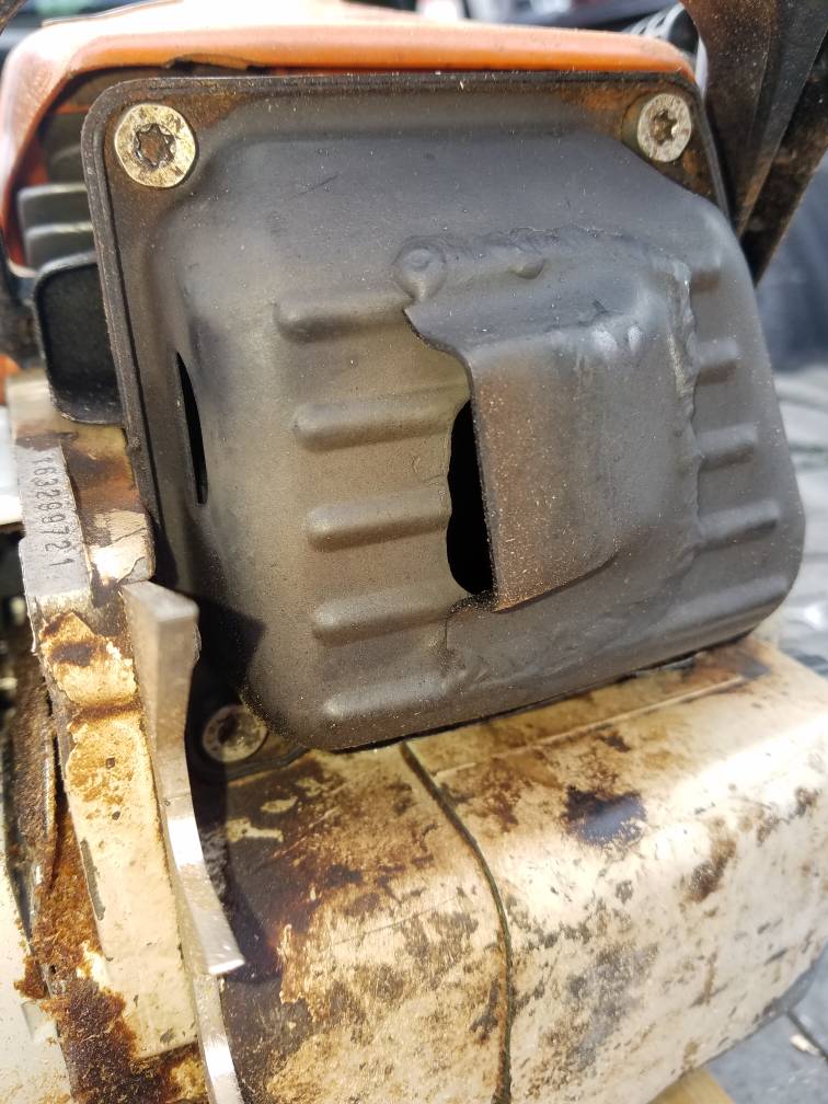

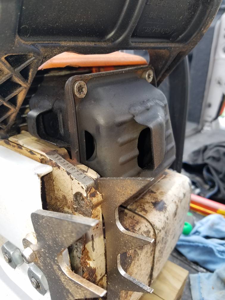

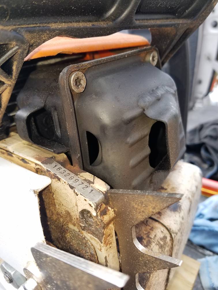

How do I muff mod this?
I don't know about modifying that thing that is standing in as the muffler...but I bet if you give it to your dog he'll lick the balls off it.
9:30 AM
Anything I've done with a side outlet and a flat front had made the same power and less noise.
I did buy Stainless measuring/sauce cups of varying sizes off of amazon to try in mufflers, but they won't ever be able to reflect back what a tube with an expansion chamber can.
Next for me is to cap the inside part of my outlets inside the muffler to prevent any of the exhaust from escaping the openings directly. Kinda custom baffling.
The more the exhaust pulse swirls, the more random sound wave canceling effect occurs.
Like Mason said, the volume can sometimes be close, but the sound is less irritating for some reason.
Capping the PTO side opening and forcing a front outlet can help as well.
Trying to create a quieter muffler that still flows is gonna be the next experimentation for me in saw porting. Flowmaster seems to have done a lot of baffle experimentation. I'll likely follow their leads.

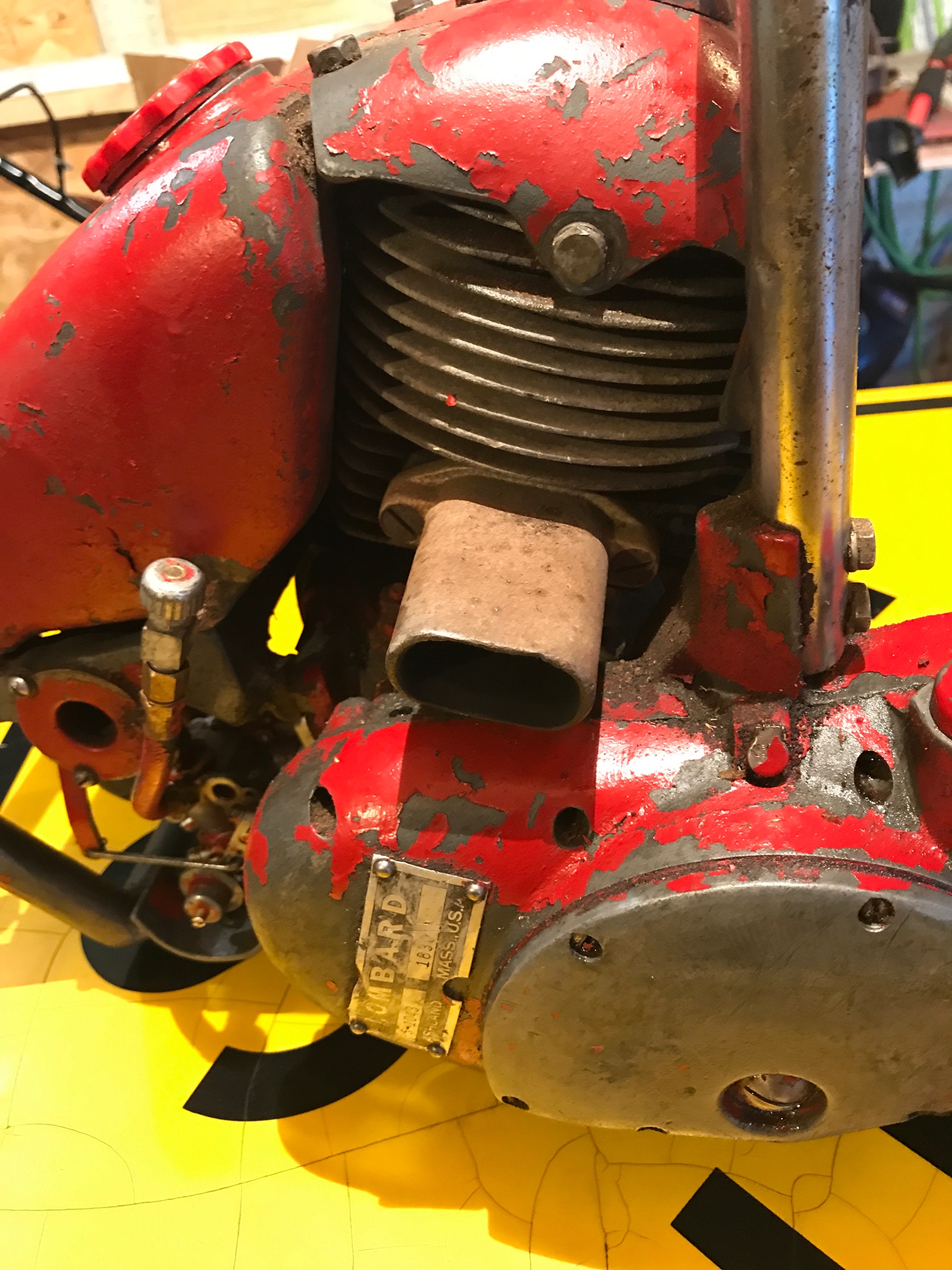

Those old Lombards with a short stack don't run fast enough to be loud . I've got two of those AH 47 engines,one on a Lombard the other on a David Bradley 360 .
