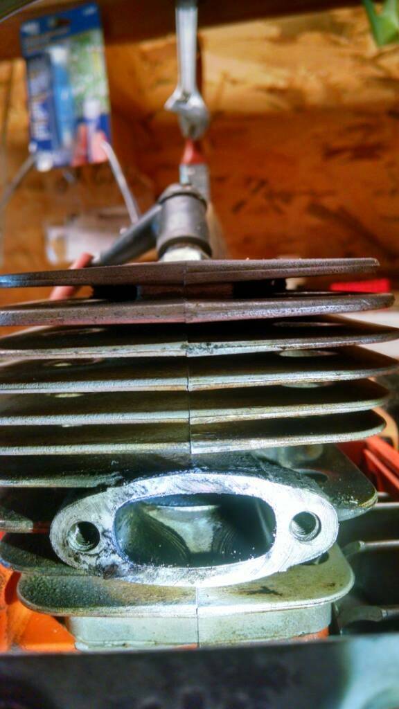

Here's @huskyboy 044. The port came out a bit square on the roof for my liking. Runs great though.
Your first picture is why I find it best to put the piston in the bore and check the exhaust roof, with the piston near the top of the roof.
