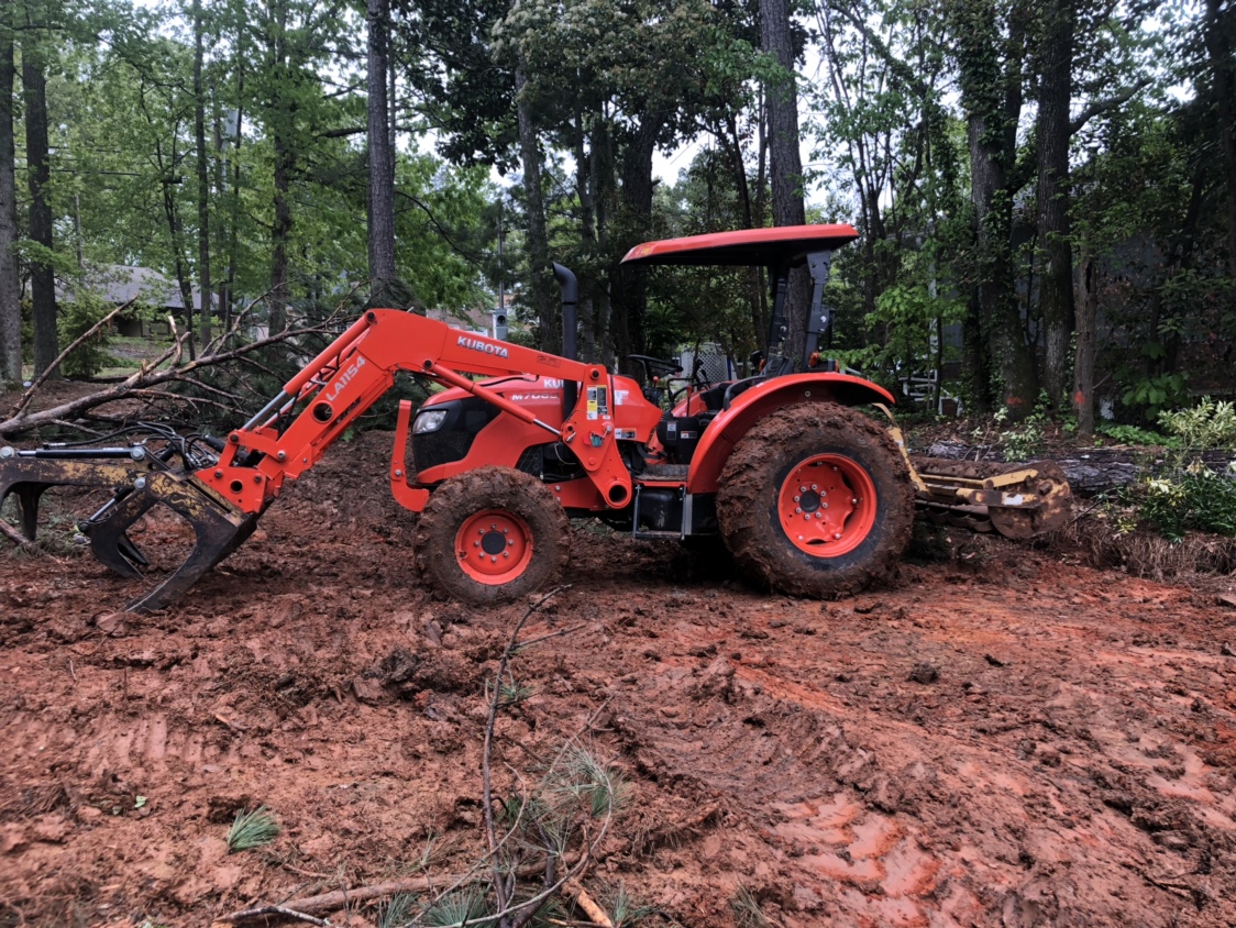

Or a 350 or 450 JD with a winch?
Meh.
I grew up on JD 450s, Cat D6/7/8s.
It just seems so foreign to try to log with them. Especially when the mud is factored in.
For better or worse I’m often trying to take extra steps to keep the saw logs clean: growing up off-bearing for granddad & dad when they were using their WoodMizer kind of engrained that into me.
To me every tree I take down is either a saw log or it’s pulpwood.
And- what have I got to do to keep it as clean as possible.
If I were logging, I’m sure I’d look at it different, but doing residential tree work, it’s often easier to clean up as you go.
I’ve turned down jobs that are too big for Tree Services due to the quantity of trees,( think 5-6 acres), but not big enough for loggers. I think a small skidder or maybe the next-size-up-from-Josh’s winch would work on my Kubota until I could afford a proper Skidder.
Here’s that Working Girl

Meh.
When it’s wet and muddy I’d take a cat any day of the week over a skidder you’ll run out less plus have less ground pressure, that said it’s been years since we’ve ran either everyday of the week steady. One thing I do remember is during our wet season the skidder would be parked a lot more doing tree length thinning vs our high track skidder.
