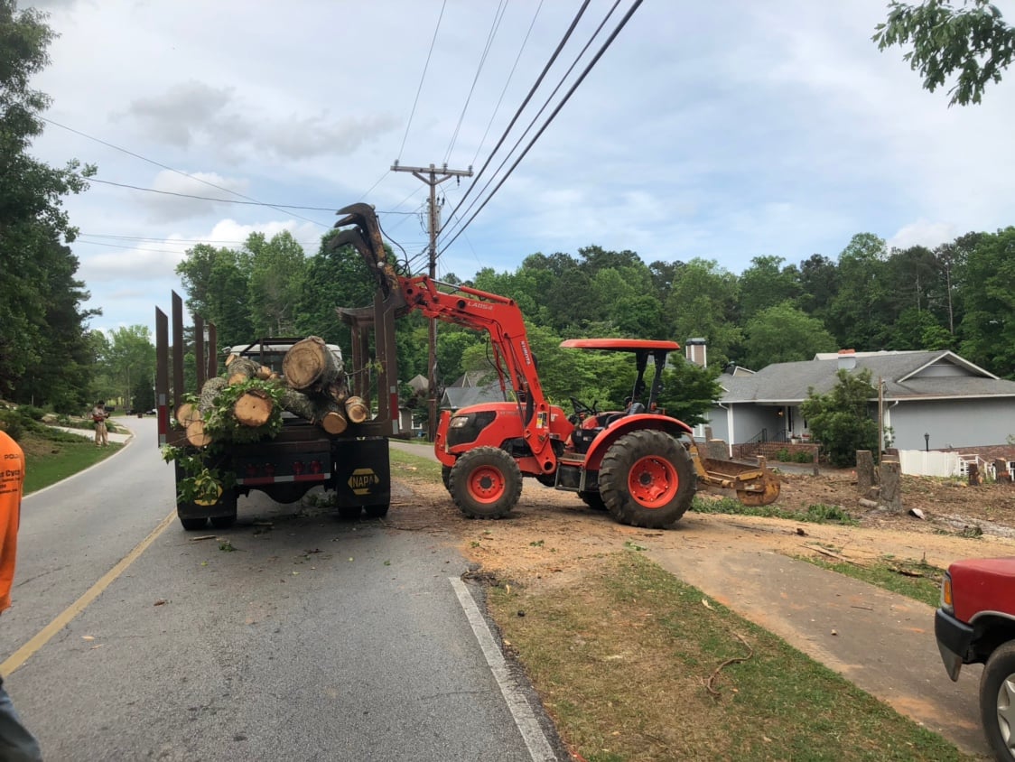

my dad's Fransgard winch. very very handy. had a pipeline run thru property 14yo. they bought the timber, marked it, dad bought winch. we cut, logged it off and he resold the logs. pipeline company was going to chip the wood. so the winch paid for itself. definitely have to watch how you are pulling, you can flip the tractor in a hurry. dad backed the clutch down, and it will still pull the tractor around.

What model Winch?
My M70

Fransgard 4000. at the time he had a Zetor 5040. nice tractor. only problem with it we would have to replace the clutch master cylinder every few yrs.
he sold that and bought the 7040 with a 84" wide fel for under 28gs

Yes I was eying the 7040.
My tractor without DPF.
