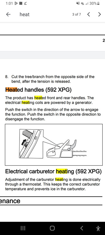

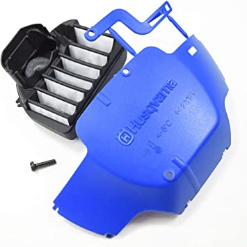

With zero stihl-arctic provisions available here in Alaska, I've been trying to find something better.
Some saws come fresh out of the box with these goodies:
Heated carbs and snap-on bibs to cover the flywheel fins(husq)
Then the echo cs 620 has probably the best winter setting of any saw I run:
a soft rubber port that runs hot air right into the filter housing.

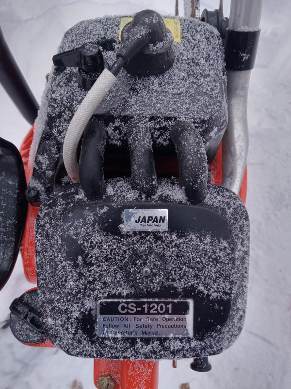

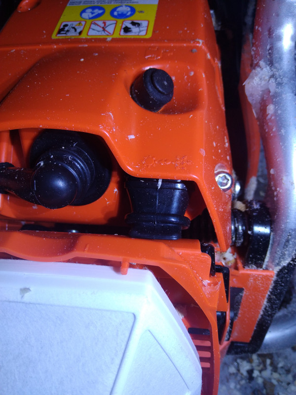

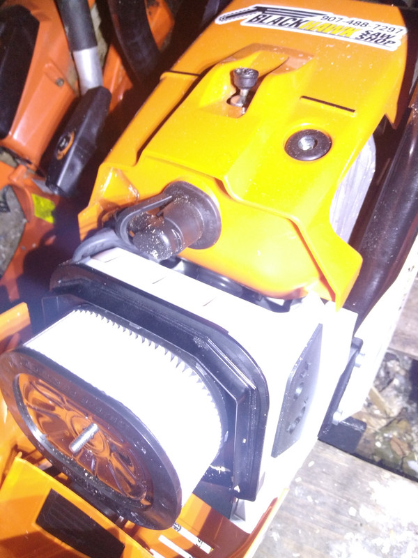

Some saws come with a worthless, archaic cold weather tab, but no corresponding cold weather port off the engine cover.
But then a 590/620 pw has a rubber duct, ported to a shutter, which is very effective:
Napa part # 600-2774 is a pcv valve rubber hose assortment. 2 kits usually provides just the right hoses to add more heat to almost any saw:
Residual oil in the crank case:
Be mindful of the cold pour-point of the oil you use. Some oils like echo red armor, the residual turns gummy as fk, even in mild below zero temps. This makes cold starts difficult.
Then others, like amsoil saber, the residual is still liquid at about 42 below zero.
