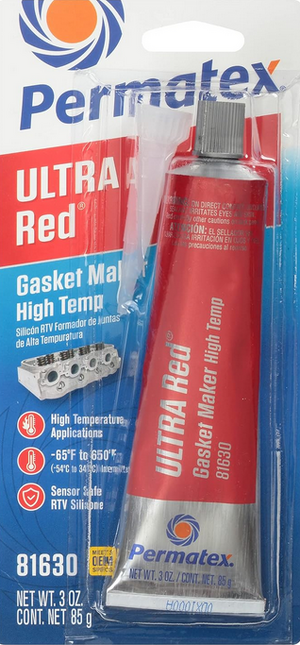

Having a hard time finding procedure to clean old glue/RTV and redo it.
For those saws, you need to use high-temp gasket maker, I use this:
I was looking for a video I have watched, but can't find it, basically, you need to clean off as much of the old stuff as possible and then you put a bead of new. You don't want too much that it squeezes inside the cylinder, but you don't want too little that you end up with leaks. Follow the instructions, I think for this one, you put the gasket maker down and then put the cylinder on and slightly tighten so the gasket maker makes contact with the cylinder all around. Let it sit for an hour (the instructions say how much exactly) then fully tighten it down. You want to make sure the gasket maker goes all the way to the bearings (where the bearing, cylinder and base meet). I recently worked on a MS 291 and 391 and they were the same clamshell setup as your 271.
Thank you very much. Will Amazon it.
