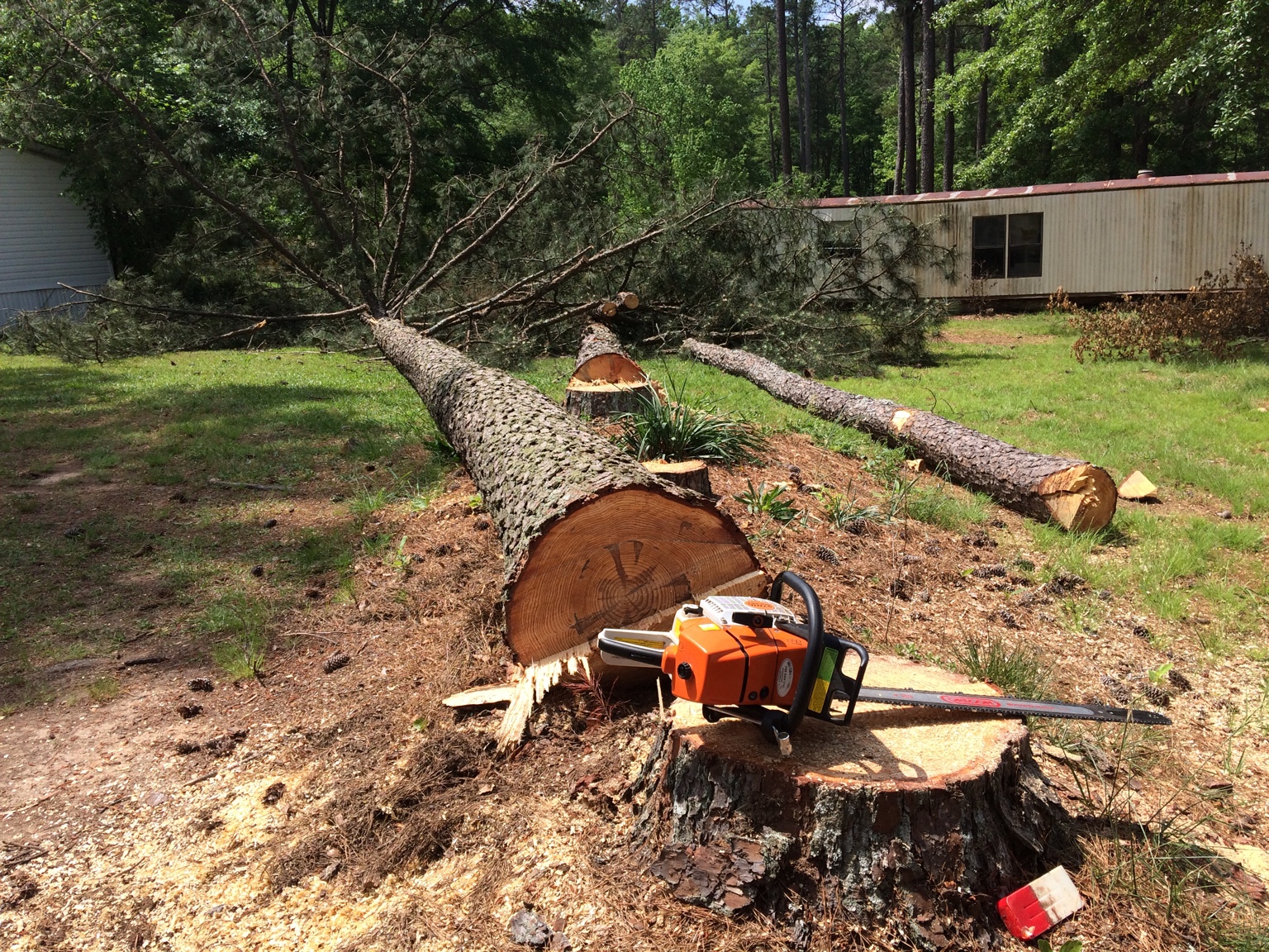

I'm going to sell my Oregon RW 32" 0.063": I haven't posted it yet.
It's nice.
Did you cut through the hinge on the right side?
hseII
Heef
2:26 AM
311
6,842
24,463
West Georgia
It does look a bit sketchy in the picture,but I would have busted that saw log had I not.
bikemike
1:26 AM
768
Feb 4, 2016
2,263
5,438
Cottage grove mn
Almost, but not completely.
That tree was in line with the 2 in front of it, & I thinned it out to lay just to left, beside the other one in the pic.
I was wondering about that. The pic was hard to tell to the structure off to the left as where the tips would land. But looks like some fun drops.
