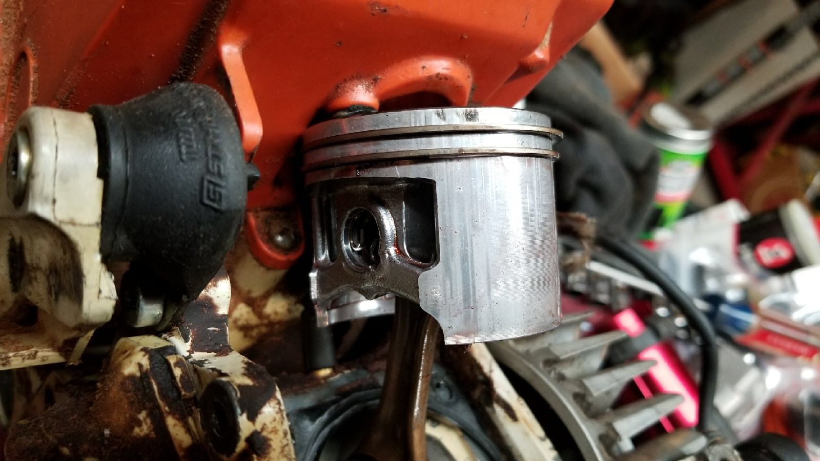

Looks to be no cracks around the small chip. I'm thinking of just *f-wordin running it. I got a 395 cylinder for it. What do you guys think? The bearings are good fortunately. I'm thinking on it. Looking closer at it its not a chip it's a small ding from when supposed bearing cage failed on it and probably hit it.

For the record the saw was ran on red armor 40:1 and the inside was slathered in thick layer of oil everywhere. So I know it wasn't the oil or gas mix causing scoring.
You should relax a little there now young gun we can see that. Start thinkng like how would my legal friend handle this. Check everything and polish that bur edge off that crank, PLEASE!

Hold the press. We have a new leader
.5 mm, or roughly .020" side to side
That will be fine. Like stick legs said How the *f-word do get something that far out man? Like, way far out man and not in a good way. That would place the top of the bore out over 0.030 WTF... WOW... And I thought I was a hack at 13 running my moped jug 0.003 out on the base. Oh, yea, I was.
Red Arma FTW!!
