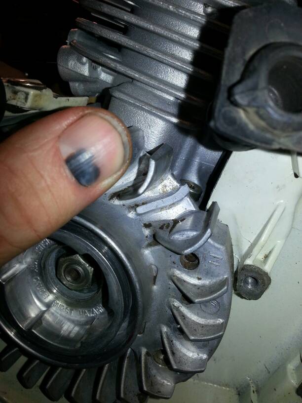

After coming into contact with the piston how many times? I always roll the flywheel back and forth until I can barely feel it. Takes maybe 10 or 12 times back and forth with .031 solder

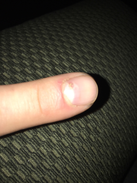

Using .032 solder if the flywheel tries to take your finger off after the first squish. You still got .006-8 to go.
Yea I always try to give it a flip the first time and get my sausage fingers outta da way. That hurts when it rolls over TDC and jams your finger into the case housing
I'm just glad I'm not the only one who has done it.
Of course I've done it multiple times. :hollering:
You're likely correct. Probably the same amount on both sizes.
