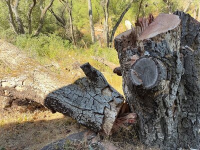

In my example you can see that forward running grain held on longer and rearward running grain broke early.
But after reviewing I don’t know how much was grain and how much was poorly executed overly complicated cutting trying to get wood to bend.
You can see where I nicked the hinge in the circled areas. Yellow side high on the front blue one low on the back. Those nicks contributed to where the hinge broke, and a tilted hinge pulls to the high side. How much was that and how much was twist I don’t know, but I have not had a problem with twist before.
