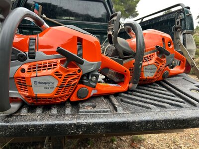

The 564XP….the most hype I’ve heard about a saw since the 500i released. I’ve unboxed it and here’s the pics.
What’s new and what’s old? At a glance, it looks like everything is new….a completely new saw. What’s old? Maybe nothing…it may share minor things with previous 5th gen Husqy saws, but they do appear to be very few.

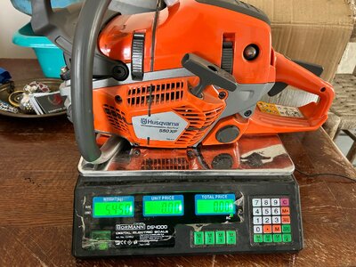

I may put it on the scale at the office tomorrow and see how it compares with a 550 Mark II. I’ve heard claims that it has the power of a 70cc saw and the weight of a 50cc saw. As far as the power goes, we shall see. The weight judging by feel alone seems like it’s more comparable to the 562XP Mark II.

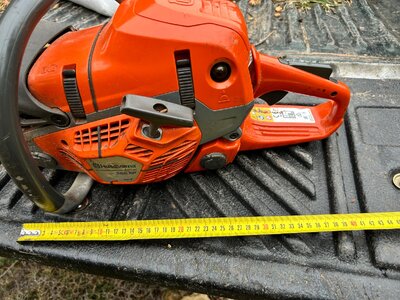

For the weight and measurements types out there…
Husqy’s claims that it is light as a 50cc saw are pretty accurate. The 550XP Mark II is just under a pound lighter.
Weights are without fuel and bar oil. Powerhead only.
Y’all have to think in commie metric cause I don’t have another scale.

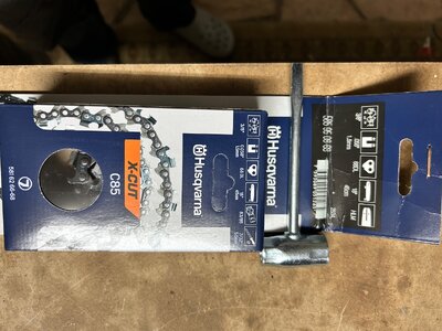

I've heard that c85 is good chain. Let us know how it cuts.
c85 is great chain. I’m not a big fan of the Xforce bars.
It's a very good chain, I left the xForce bar in the store and brought a couple of extra chains with me instead, I had a 20" Tsumura Premium lying around for it.

It is probably closer to the weight of a 560mk2 than it is to a 550mk2, but with a long bar mount.

In my application and in my hardwoods here, I was not a big fan of the C85 out of the box.
With too many good reviews, I too thought that it would do well.
I tried to run it with the 372OE monster build by our friend @Stump Shot Steve and the chain was sub-performing.
Once the chain was correctly re-adjusted to my application (fiber and operator skill) all was good.
