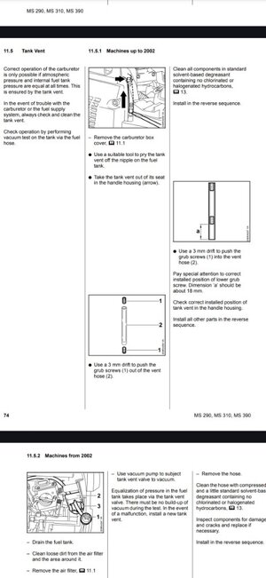

I’ll start by ms ms290 is holding 10lbs of pressure and vacuum. I have no idea why it’s wanting to revv up on its own. To me the tank has awful lot of pressure. Faulty tank vent? I always start with pressure test to identify my leak but I’m stuck on this. Thanks in advance

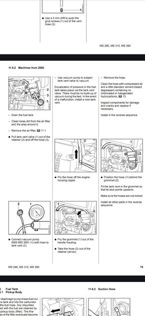

Here is the pages from the service manual on how to test the tank vent.
Operation of tank vent at gauge
pressure: 0.3 bar (4.35 psi)
