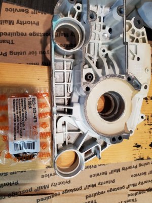

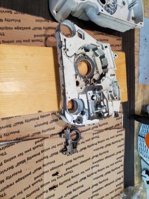

I started with the pto side case and bolted up the oil pump
Oem proprietary bearing.

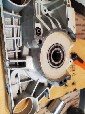

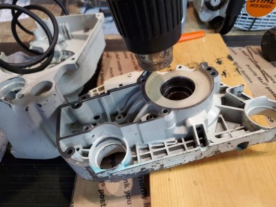

And with my heat gun, warm up the case..
Once it's ready, the bearing pretty much drops in and bottoms out on the previously bolted up oil pump. I keep a 1" socket close by in case a few light taps are required.
After that, I install the flywheel nut on the crank to keep the threads from getting boogered.
By the time I'm done with that, the heat from the case has soaked into the bearing. I will usually apply a little more heat if it's too cool.

Remove the oil pump.
Here's the oil pump screen and hose.
