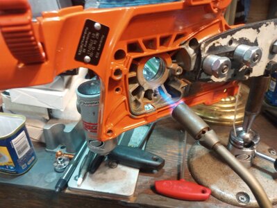

I can only speak for the Husqvarna 5xx series, where the crank bearings must be all the way to the bottom of the bearing pocket, there is little wiggle room for the crank sideways.
We can mount as we want, I know that with a heated crankcase and cooled bearings, the bearing will reach all the way to the bottom without filling the pocket with magnesium shavings.

I am one of those that would heat the case, put down the torch and then grab it by the hot spot not thinking and instantly wondering why I didn't have any gloves on....
I have a new to me toaster oven in my shop, I will have to give that a try!! Welding gloves...welding gloves...welding gloves....have to remember the welding gloves!!
Screw all that. Use the one in the kitchen and assemble in the dining room. The snacks are closer.

I use the oven in the kitchen, goes faster than baking a pizza.
Short distance to the freezer is also a bonus lol
The only downside I've seen is that plastic parts have to be disassembled before baking!

Yea, you have to pull the plastic. I have an oven in my barn. I leave the cases in the oven for 30 minutes, sometimes more so it bakes the oil out the case. I don't think the wife would appreciate the fumes. I have a chest freezer in the barn too. I assemble the cases out there and then take them to the shop. They are cool when I put the oil in and do final assembly. I learned along time ago that good redneck game is to maintain your pile of broken machines where the wife can't see them from the windows of the house. The less she see's or smells the less she thinks about it.
I read somewhere that the nylon cage has less friction than the steel cages. Plus they pop out of the bearing easy. I've got a 562xpg in a box that's waiting for a rebuild. When I do it I'm going to swap ceramic balls into the bearings to see how that works out. Plastic and ceramic should be the lowest possible friction and thus heat generated.
The plastic bearings are rated to 110 to 120C. They are constantly cooled by fuel flowing through. If the bottom end of your chainsaw is hitting 230 to 250F you got problems.
Ahh the joys of my life being I wash crank cases in the kitchen sink and depending on seneiro, fuel tanks in the bathtub.....( I'm so lonely 🤣) Anyways lol Hot water and super clean work great at cleaning any oil off case halves if I decide to go the oven route..
Screw all that. Use the one in the kitchen and assemble in the dining room. The hostess jumbo iced honey buns are closer.

Stihl concrete or cut off saws like a TS-420 have some type of rubber/ neoprene or whatever flat seals that fit in two grooves in the bearing. If they are not perfectly in line it can catch the rubber seal and deform it . And, I am not sure about freezing the bearing with the rubber or putting that rubber material in a hot case either. So, we just furnish the crank halves new with the bearings already installed.
Any thoughts on that.
