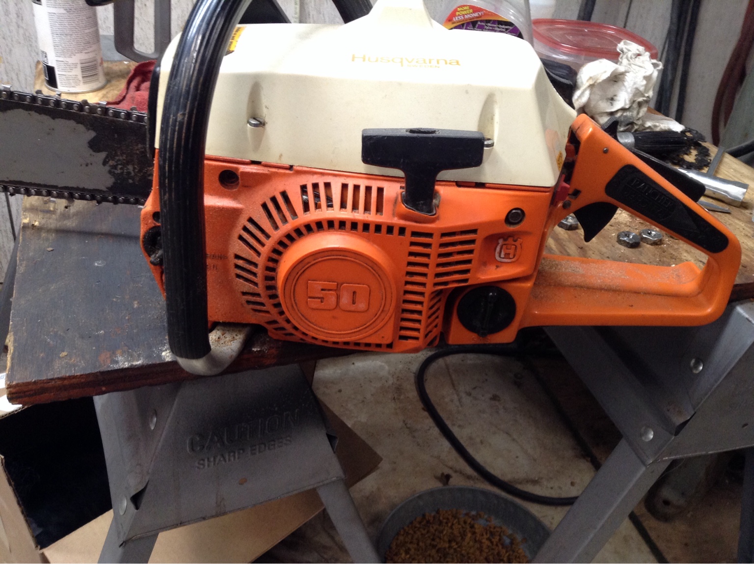

Almost all back together now less piston, top end mocked up. Just need to knock the rust off the muffler and paint it. Got a big bar mocked up to see what it's going to look like. Will most likely be wearing a 32" most of the time. I got my piston and ring set from HLS. Does anyone know who makes these aftermarket pistons?IMG_1953.jpg

That saw might be a lot more crummy than the crummy! But it's a good foundation!
