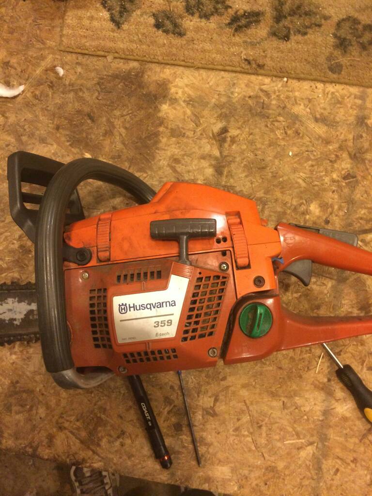

Which makes me wonder... Is it possible to install stuffers on the 359 crank to do a complete 357 conversion?? I'm thinking the 359 uses the same crank, or is at least the same stroke... Bore is the difference between the two...
Oh, here is my soon-to-arrive 359... It's ALMOST as nice as those!! LOL! :D:meparto:

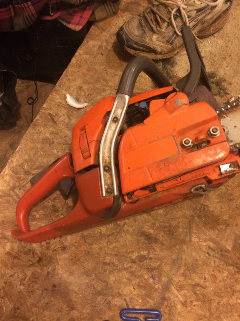

After a couple years of cad, finally joined the six cube husky club. All torn down now getting new mains and seals, piston and rings, carb kit, fuel line and some other doodads and whositswhatsins here and there. Really excited to throw it in some wood and see how it goes. Never ran one before.0303161507a.jpg0303161507.jpg
