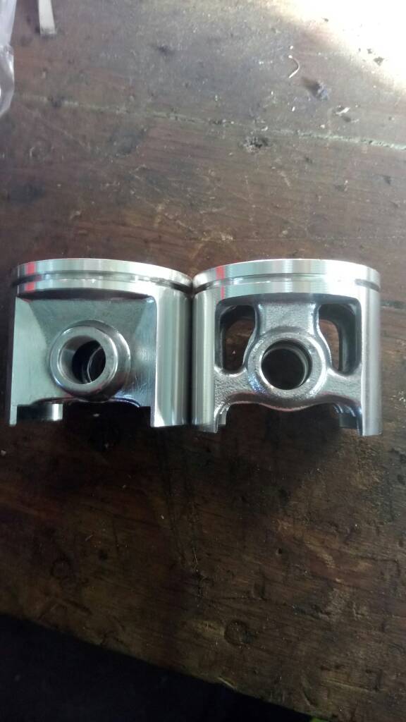

was looking for replacement piston when this came up
"For purists, there are some aftermarket full skirt pistons out there. Forester is one that I know of. One thing you gotta watch though is that there are a lot of pistons out there labeled as fitting the 266/268. Many are for the open port 268, and they run like crap in the closed port saws. The one in the pic is the correct one."
have you a pic of the OEM piston and after market , so i can understand what he is talking about

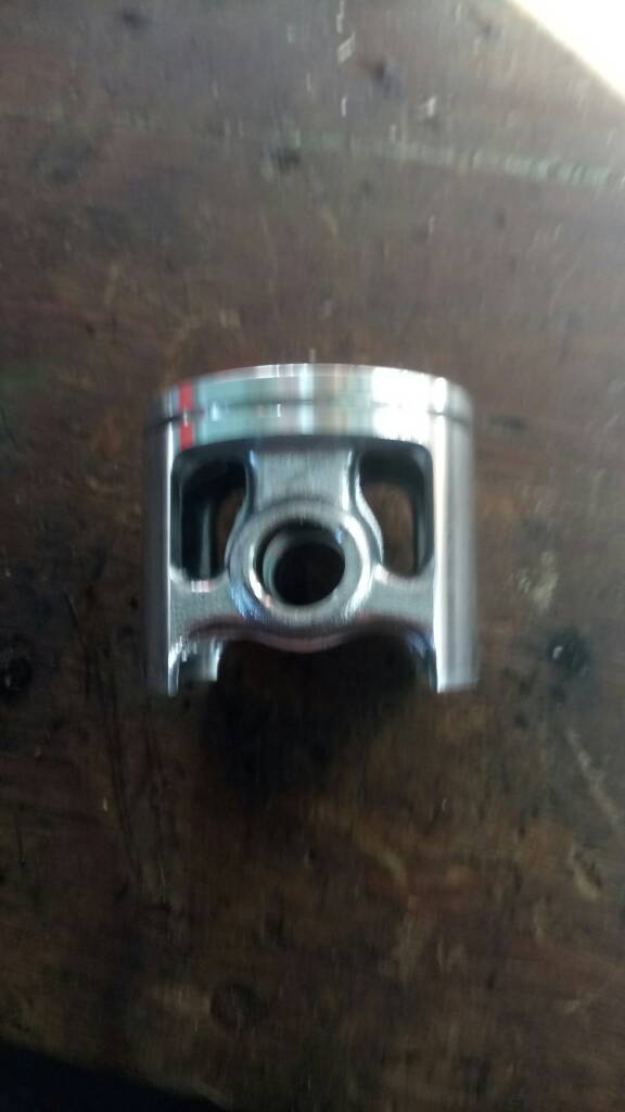

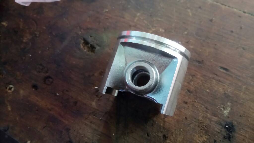

This is the aftermarket 268 piston. It's made for an open port cylinder. No windows
This is the proper 266/268 closed port windowed piston. This is a meteor but oem looks the same
