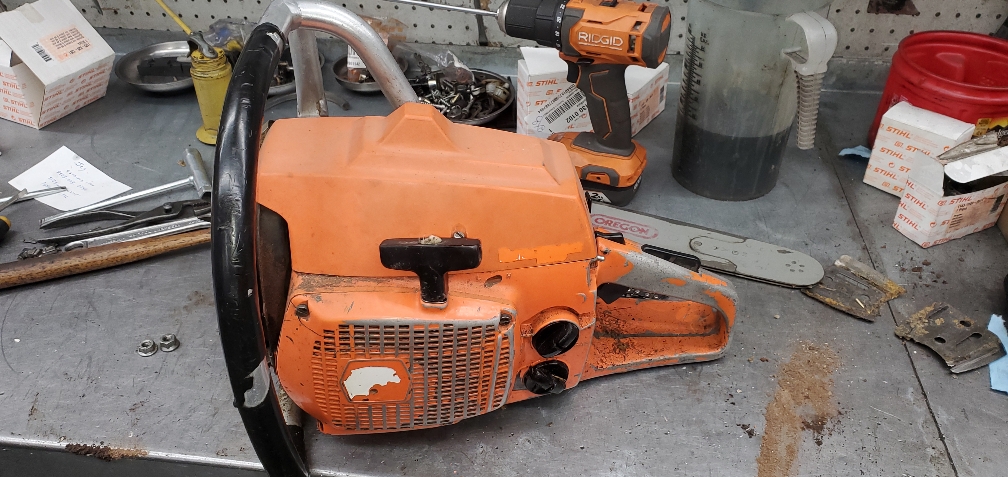

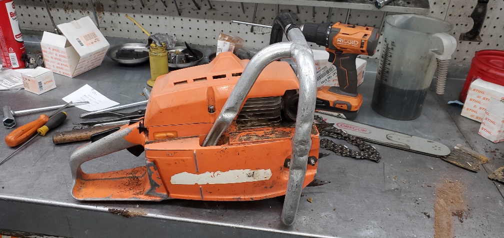

Working on a 257 at work, needing fuel and oil caps. I bought the proper part number caps from the Duke, but they still leak. Is there an updated cap, off of a newer saw with another O ring on it?
Oil 501 76 56-02
Fuel 501 81 96-02
