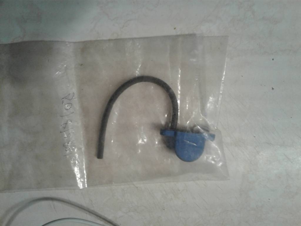

Yay look what came in.
I should be able to make the 181 run now.
Then i can tear all apart and see what else it needs.

On the topic of those triggers, can a guy repair that plug wire section? Ive got one that works, but has some pretty serious damage to the wore in a couple spots.
