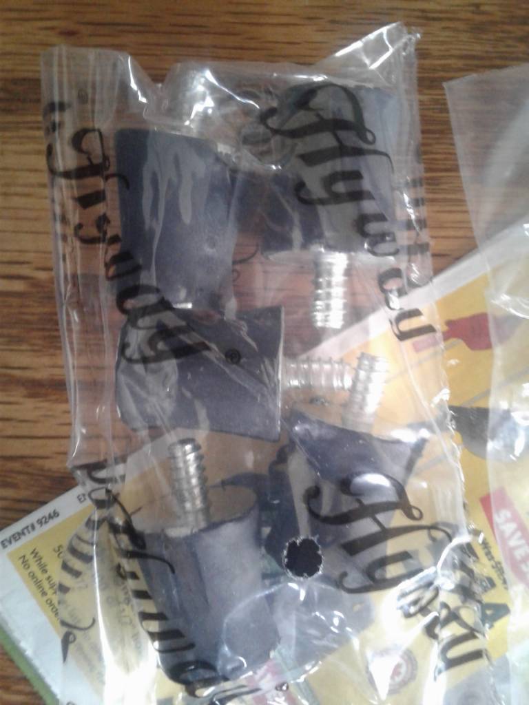

Finally got around to putting the coil on my 181. Dribbled some fuel down carb and she lit rite up. Now i got to order some antivibe bushings and replace them. Get a bar and chain or i think i can run my stihl bar with an adapter?

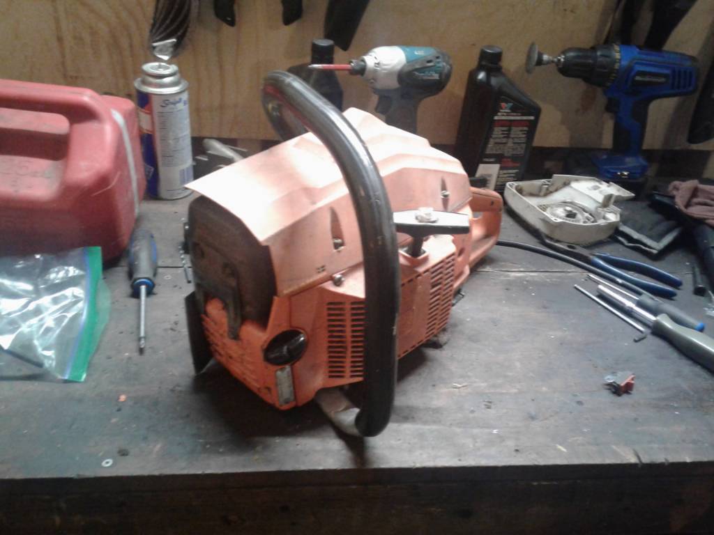

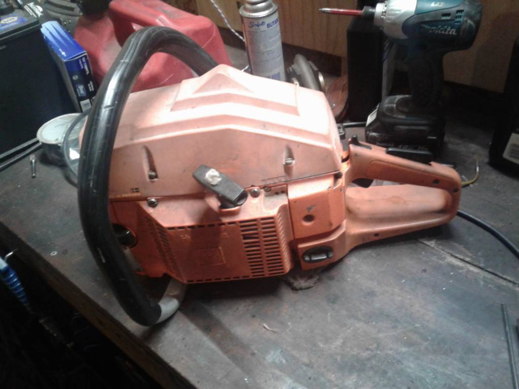

Here it is somewhat back togeather.
It even fired up and ran....

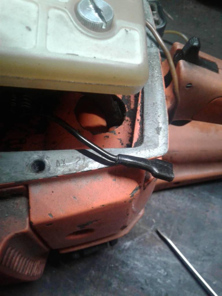

Just gotta figure out the kill switch. Got this one off ebay but dont seem to fit propper in the hole for it.
I tried to post a video of it runnin. Not sure if it worked.
