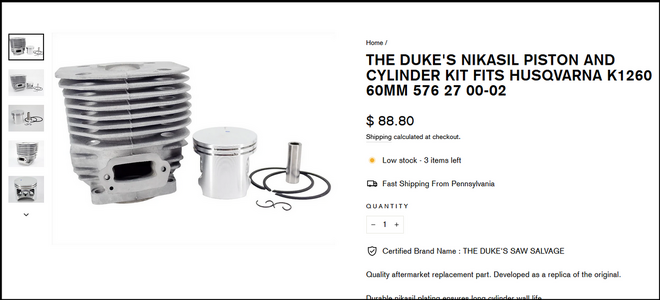

I agree, those saws have good balance. I ended up putting an AM piston and cylinder on the 576 and it has been running great (someone detonated the original piston putting a hole through the top and both ring lanes. I have another 575 to work on and am looking forward to seeing what is going with it.
That’s good to know, what AM p/c did you use? I haven’t even had a chance to look at these ones, I have a couple other projects I’ve been working on. I’m hoping at least 1 of each cylinder is good enough to clean up. I’m trying to do these saws as cheap as possible, I need to stop sinking money into saws. I tell myself I’m gonna fix em up and sell em but then end up liking them and keeping them 😂

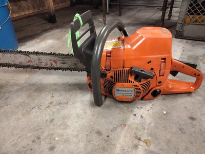

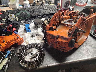

Started working on the 576. Was told that "it wasn't running right". Looks like it was dipped in mud, but the piston and cylinder are clean. The carb had a crispy diaphragm, which I am sure that didn't help much.
I started cleaning the parts on the very left, will work on the cylinder and other parts tomorrow. The fuel tank is all nice and clean now too. I found an extra 576 carb in a box of parts and robbed the diaphragm from it. I have a few gaskets left over from a previous repair, so hoping to get this one running without having to buy anything.
Make sure the throttle cable is opening the throttle all the way. May dad had several of these back in the day and the throttle cable would get worn and not pull throttle wide open

It's as clean as it is going to get for free. I actually got the cylinder and the muffler back on today. I need to clean up the clutch and I can get it, the flywheel and coil, fuel tank, front handle and carb installed. Should be ready to test fire on Monday evening.

I put fuel in the saw, pulled 5 times, it burped, dropped the choke and it fired right up. I needed to do a slight adjustment on the low screw and idle, but the saw just purred. When it was time to rev it up, it didn't hesitate. I really like the power these saws have.
Earlier I stated that this was a 576, but realized later on its a 575. It is now ready to go back to work!!
