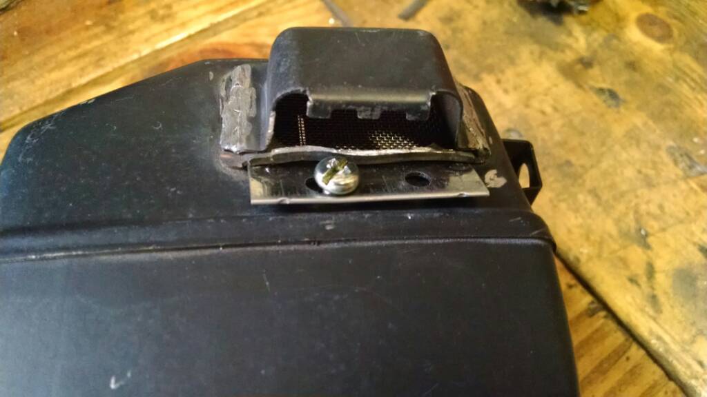

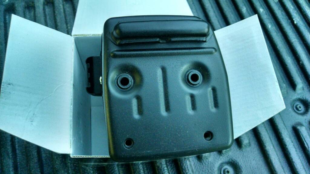

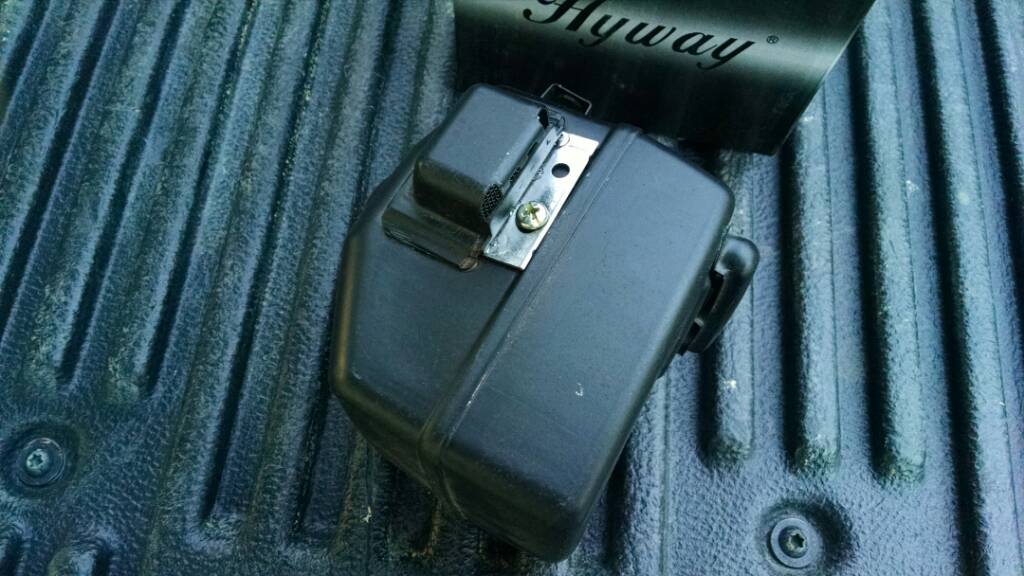

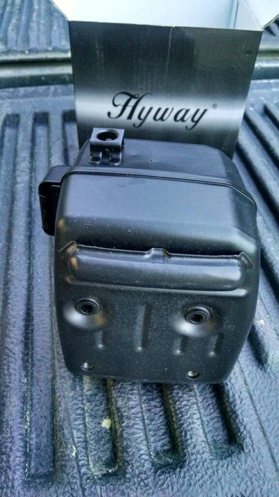

yep... I agree, not much point in buying oem for the 394/395's ... hyway is fine. add an extra 288xp exhaust port and you have a harley![]()
That does suck. I just got this one Tuesday.Well that sucks balls!
I get the regular Friday specials email from HL Supply and they have the hyway 394/395 muffler discounted to $19
All too late for the couple of us that sparked the interest :-(
