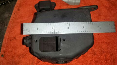

Anyone got any good muffler mod pictures of 394/395 mufflers?
Fishing for ideas.
I have a few medium @Red97 deflectors, and looking at the single little hole in the stock muffler, it will respond well to a 2nd opening.
I am thinking of putting a 2nd deflector on the same side but on the forward section of the muffler case

Looks like you have plenty of room to add a second port on the clutch side.
Probably get away with opening the whole area under the medium deflector. While opening up the stock outlet a bit too.
That's my plan for the Hyway muffler.

This is under the stock deflector.
