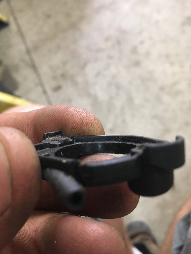

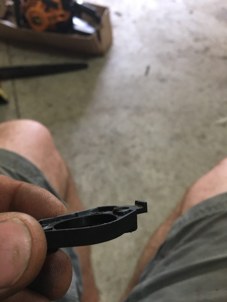

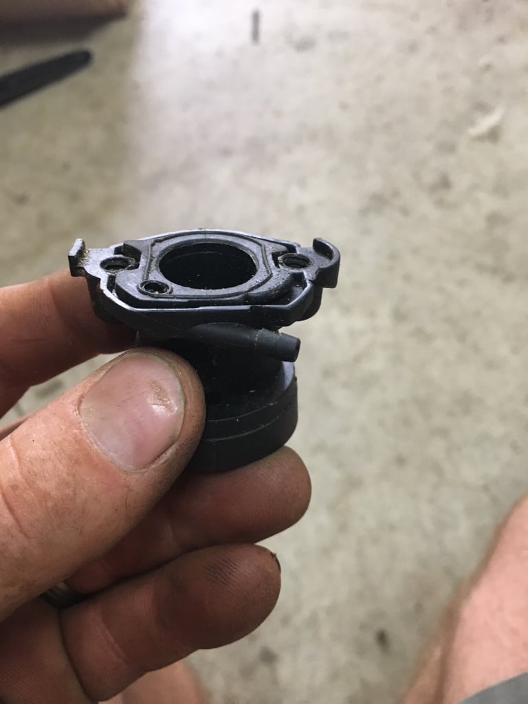

I started to do that, but I haven't seen it leak at the cylinder yet. The plastic intake to carb has been the issue. Seems it deforms a bit. I fixed a couple with a straight edge and file, but I'm using anaerobic on them now.

My bad straight edge not needed. See the raised threads on the plastic flange.they are raised and keep the carb from seating. I think they pull into the screw hole on the carb, but then don't line up perfect when reassembled.

I've found the sealing surface on the flanged portion of the boot, where it meets the carb body to be very troublesome on these. I've had several that look great but won't seal properly. I've had mixed results on honda bonding them too. Trimming away the plastic flange slightly has helped for me in the past if the boot is collapsed slightly. I like tinkering with this series saws but the impulse/intake boot setup is downright stupid. I've lost my cool many times on them.

You also have to be careful when putting the boot onto the intake on the cylinder, if you push too hard onto the aluminum intake, and clamp it down, you deform the boot, you can see it when you look at it from the carb side of the boot, and, of course, that intake nipple has to be on just right. Now add in those fantastic boot clamps that give you a heart attack putting them on makes this challenging. (I have done 6 of these now, I am a glutton for punishment)
