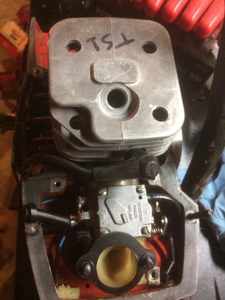

Took off that big aluminum piece off the front and put some spikes I had on it. Piston looks almost new and you can see the machine marks but there's a lot of carbon on top of the piston so I'll be pulling the top end and cleaning it up. Someone offered me a filter cover but I'm waiting on the payment info, hopefully he comes through. I sat a 272 cover that's been dyed black on it to see what it would look like but I like the Jonsered cover better.

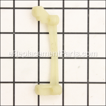

Is there a 272 piece that goes on top of the intake block & bolts to the case? 272 top end on a 625 II
Ronie
11:06 AM
5495
Mar 2, 2018
2,668
9,008
NC
I don't think so. When I put a 272 cylinder on mine all I used was was the rubber piece that goes around the block. If you use the filter box from a 272 there is a brace that bolts to the case over the block.
