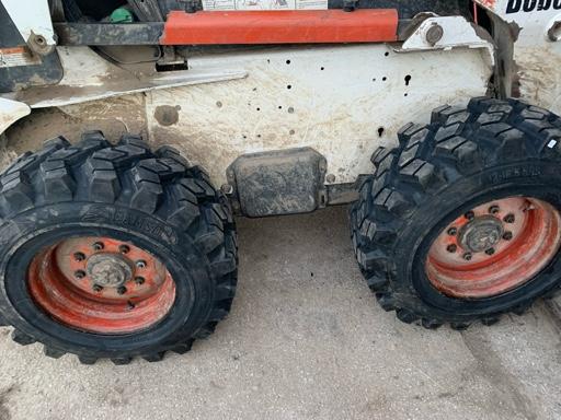

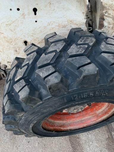

Traded my tracks for a new set of tires with some credit
