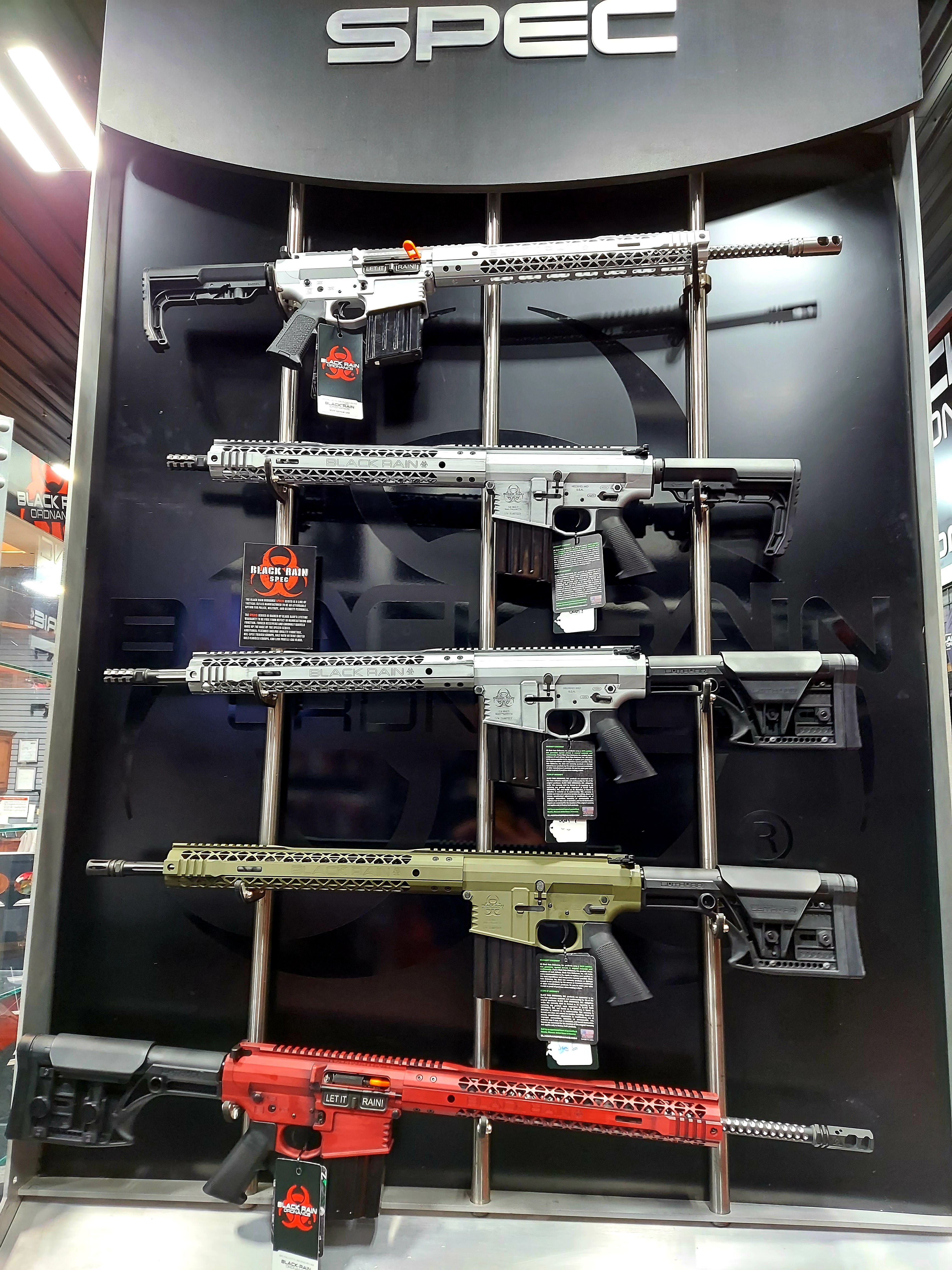

I did a mechanical inspection at Sarcoxie the other day so I dropped by Black Rain Ordnance by Neosho to check it out. They have a very nice store front at their manufacturing facility. It's a candy store for AR fans.
