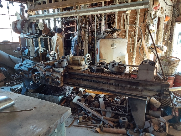

Went to an auction yesterday that was like stepping back in time. A machine shop that did a lot of heavy work back in the day.

Anything interesting there?
Everywhere that you looked there was something interesting.
4 large business buildings on the main street of the town full to the brim.
I'm headed there today for day two.
The only down point is a fair portion of the items would need a forklift and heavy trailer to move and transport them.
I couldn't count how many power generators that are there. A lot are military surplus and pretty large.
The auctioneer said that he was going to have a 4-5 day auction at the same person's residence in the spring!
That great big cutter is pretty interesting, I thought it was a drill bit at first glance. I’m not sure the Bridgeport DX’s I used to run or the Bridgeport lays thru had would have snort to do much with that. We didn’t have a horizontal mill.
