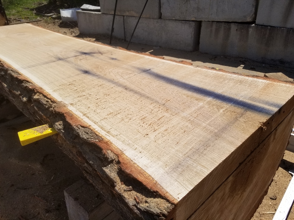

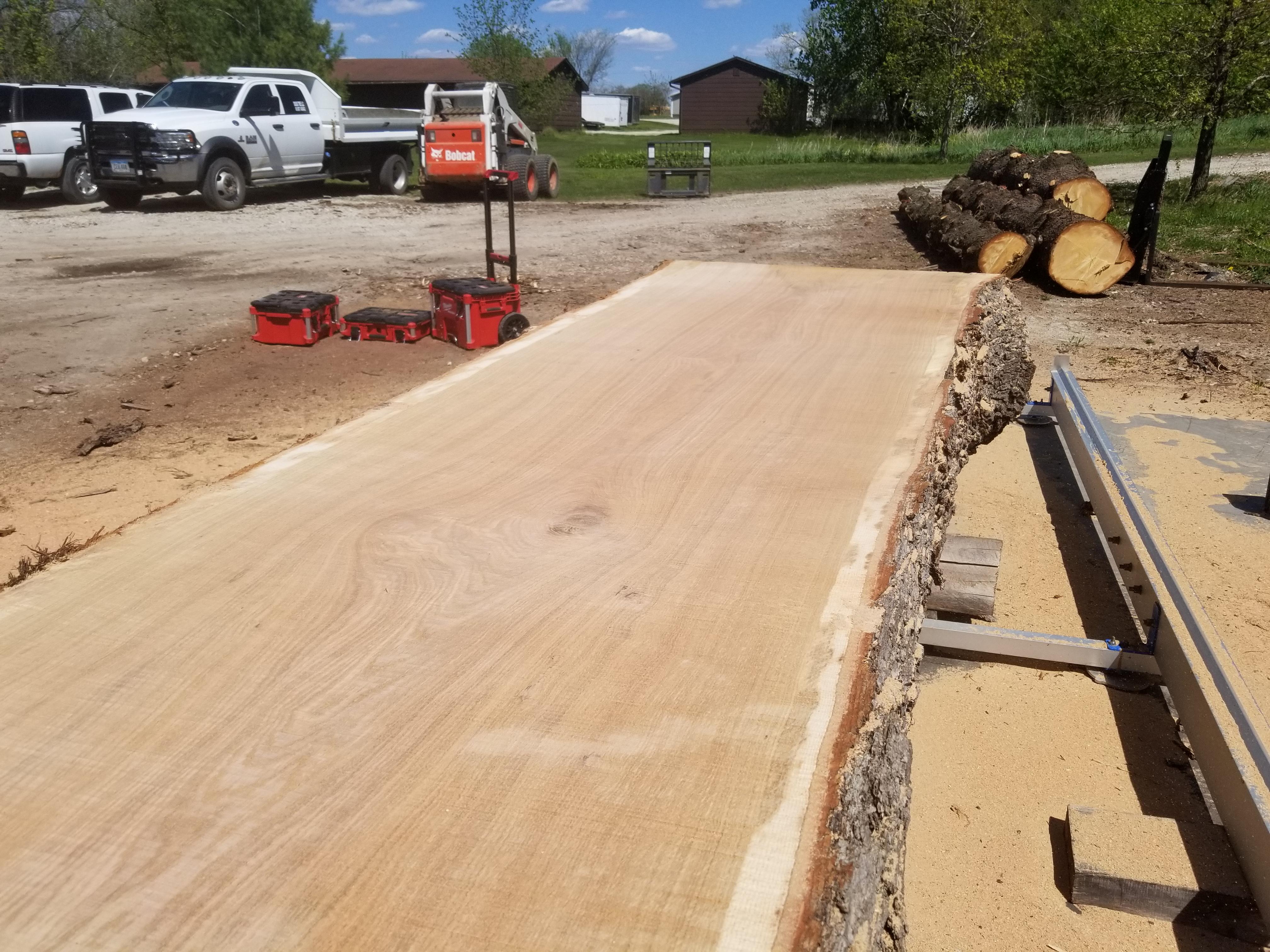

This log made some nice slabs. Only one knot. 34 inches wide 11 ft long and straight. Had a bigger log but after hitting metal 6 times it became firewood
