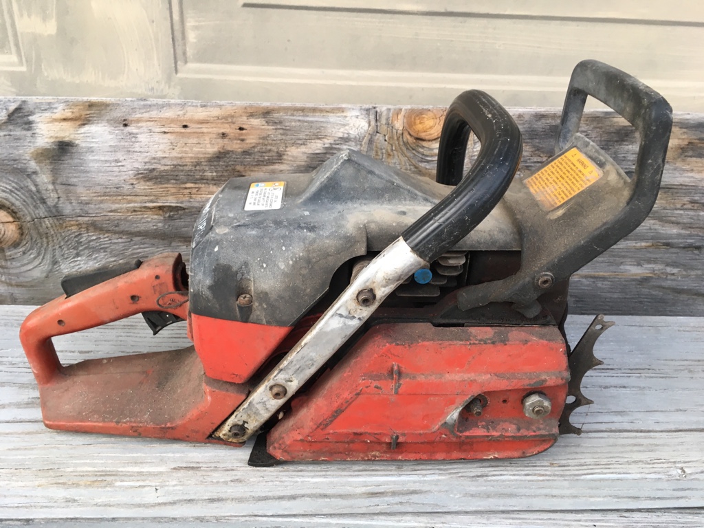

Sinkhorn & Son Tree Service picked their MS261 & 461. The geezer got paid. [emoji108]
Herman left another of his orphans to investigate.
Hasn’t been run in a Coon’s age.
Choke handle missing.
It’s a Husqvarna 365 sorta, kind of, right? [emoji848]
Pumps 155 & fat spark. [emoji106]
Should be a husky 365.

That will clean up nice. So was that your payment or a I need this out of my way.
It’s another ‘see if you can fix it’ project like the MS261.
The Sinkhorn Brothers been doing trees for some thirty years. I think Herman is digging out the storage shed. [emoji848]
Ran on the third dibble. [emoji106]
One has to pull out on the decomp valve as it needs cleaning or replaced.
Pumps oil to the bar mount If the tank isn’t empty. [emoji6]

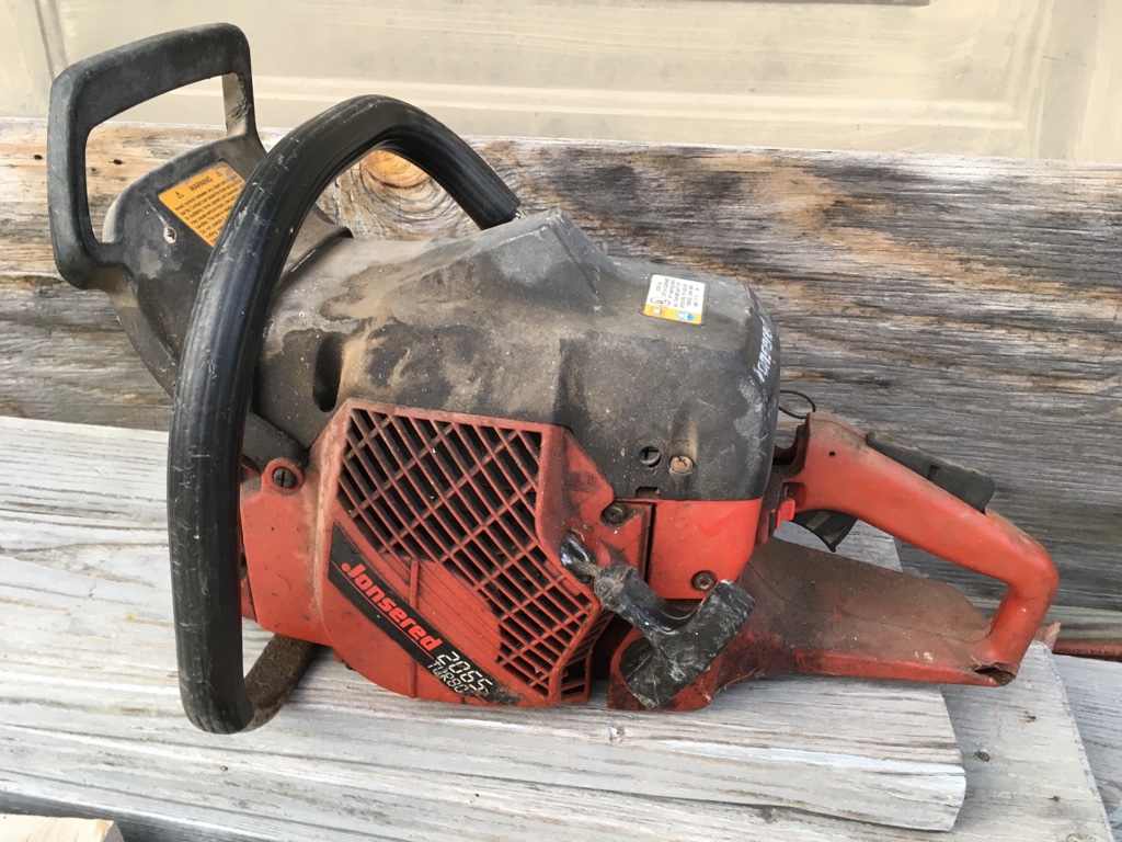

I think the 2065 is equivalent to Husky's 362. Open port and 46mm bore. The 2165 is same as 365 special.
2063 is the 362 red cuz. I had a 2065 it have the large mount and op jug with the bolt on intake boot.
Appears to be a crapshoot on the jreds . Some 2065 are open and some closed. Can’t tell without seeing the transfers or intake boot. Seen ‘em both ways
