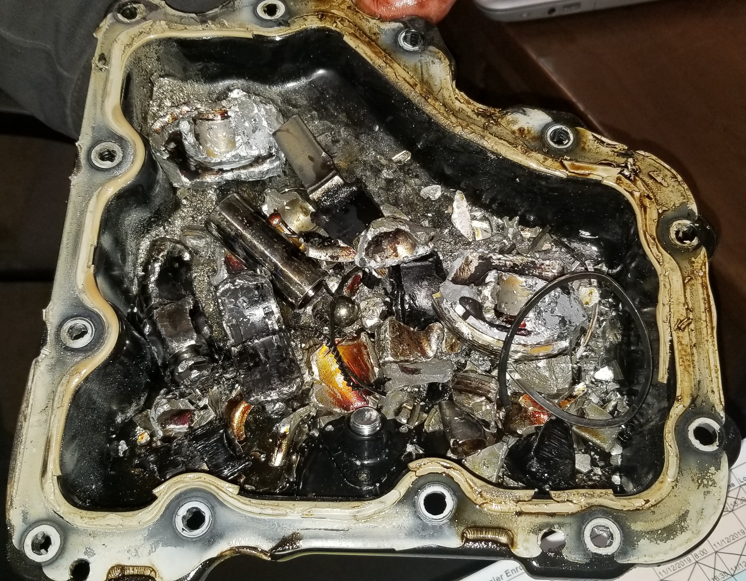

Good morning.
Rule #1
Don't tow your brand new vehicle behind your motorhome with the manual transmission gear.

Good morning.
Rule #1
The countershaft not throwing lube up on the output I suppose.
[emoji848]
Rear drivers are best towed long distance by dropping out the rear ‘U’ joint and hanging up the shaft with a coat hanger.
Front wheel drive needs a dolly.
[emoji848]
Actually with this model, all you have to do is put the transmission in neutral to flat tow it.
[emoji848]
I think that's the engine bottomed end? Looks like pieces of pistons and wrist pins. And a piece of a rod left.
Yes, that's engine carnage. It churned for a while before it was discovered.
