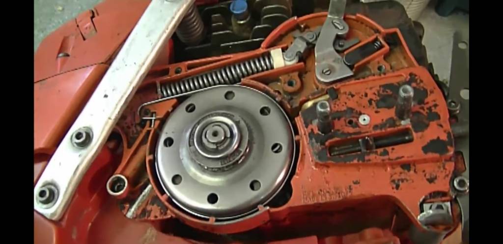

Here you go Carl. See if this helps.
Quite a bit actually.[emoji106]
The Farmertec has a plastic detent/follower. Cheap A holes.
I need to force the knee joint into the released position and then install the handle lever. [emoji848]

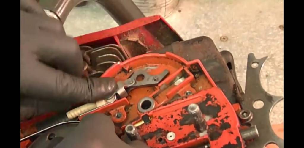

Got the 365 chainbrake installed, I think.
Put it together in the ‘set’ condition. Had to chuck the mofo up in the bench vice to crank it to the ‘release’ point.
Will find out if we need a two foot cheater bar to re-set later.
I give Husqvarna a D minus on it.
You don't have to put it together in the set position. Leave the spring out, assemble the arm then put it in the tripped position and slip the spring in.

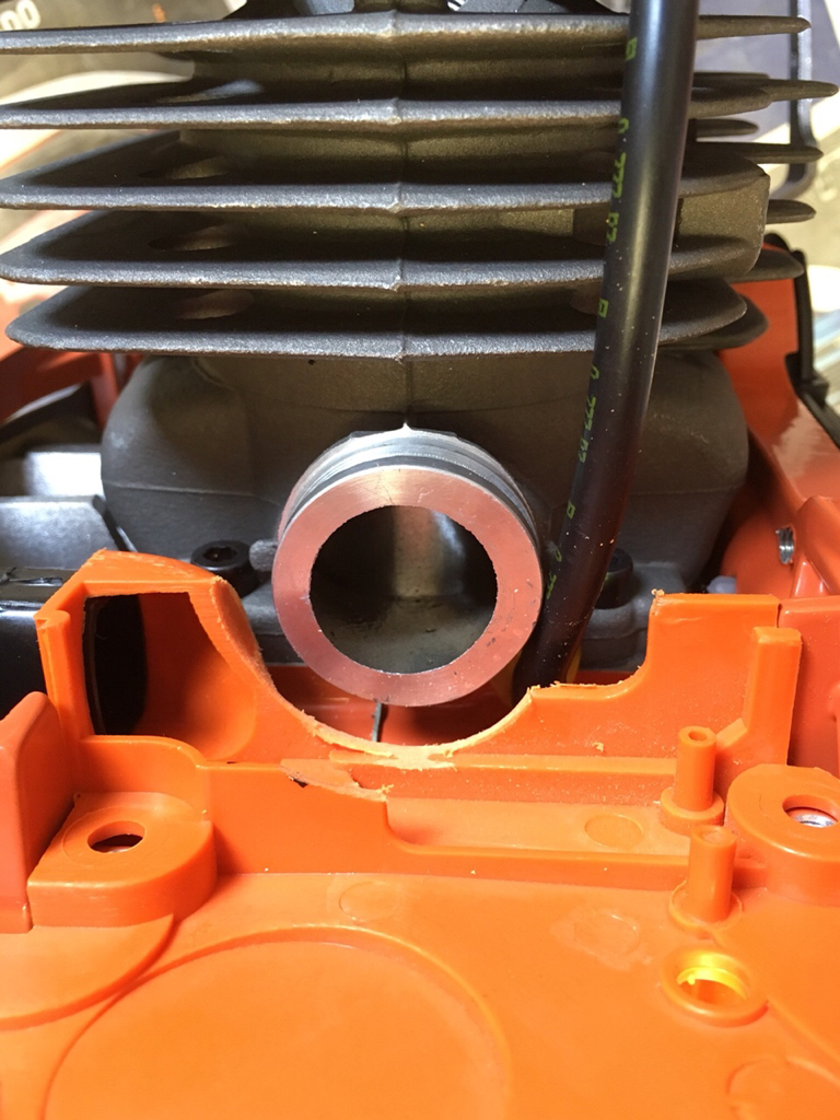

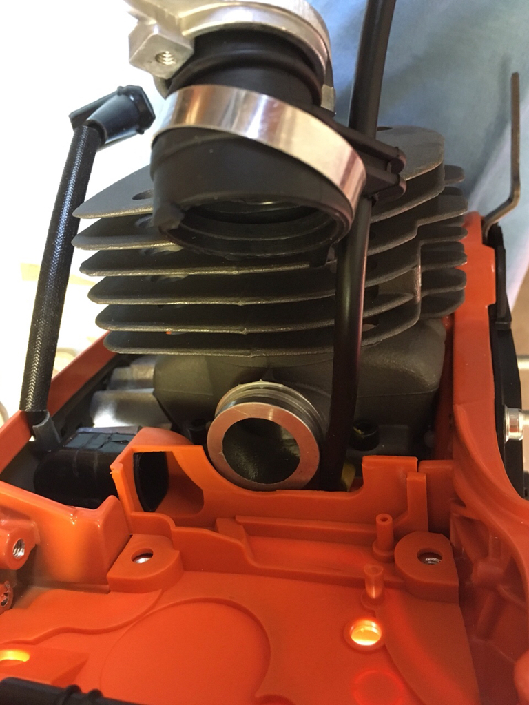

Should have put in the plastic ‘shelf’ thingy before dropping the jug onto the crankcase/piston.
‘Do-Over’ next step.
Put the plastic shelf down, impulse line on and the intake on the cylinder before putting the cylinder on.
Yup.
But I’ll Dremel for a bit more clearance as it looks like it will rub the boot. [emoji848]
