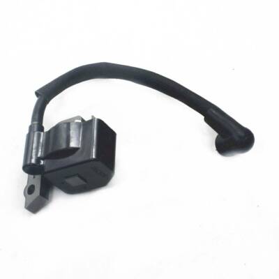

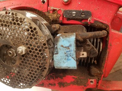

I have a Super XL on the bench with a blue coil, and naturally there is no spark.
I will leave this coil in the oven overnight (185° F) and see what happens. Assuming that does not help, has anyone tried any of the aftermarket coils?

Temperature usually damages the ignition coil 😎 The only thing that can help is cleaning it, it helped me once on a lawn mower

What does this do, clear out any moisture that has potentially gotten inside?
Yes if the coating is cracked baking it will remove the moisture which is shorting the coil internally. If you get the moisture out then it sometimes regains spark and you can reseal it with some more epoxy or an automotive rtv. Sometimes this works and sometimes not.

More times than not a self contained coil what will fail is the built in trigger device .Some times the oven trick works some times not .A points type ignition seldom has a coil failure .
Coil swaps can be a puzzle to solve .However can be done with some research and a lot of luck .One example is a 272 Husqvarna coil to replace the two piece coil on a Partner p-100 .
What would be of help is if somebody came up with something like"Holladers Interchange " but none I know of exists .
I once replaced a faulty points type coil on a Briggs 5 HP on a rototiller that some so called expert said couldn't be done .I did it ,self contained and cheap .You'll never know if you never try .

The point ignition coil does not have electronics, so it is harder to damage it 😉👍

It must have been a moisture issue because this morning it works. I don't know how long the oven actually stayed on, the coil was still warm this morning but not 185° hot as I left it last night.
The baking information comes from Leon Crouch's House of Homelite; his theory was also that moisture creeps in and the heating dries them out again.

Really not much to damage in a regular coil, it’s just wire wrapped around a metal and composite core with epoxy. Low heat I don’t see how it could do anything bad to it 180 degrees is nowhere near the temp it would be operating at on a hot sunny day milling or cutting large wood in say Texas ect on a 120 degree day.
