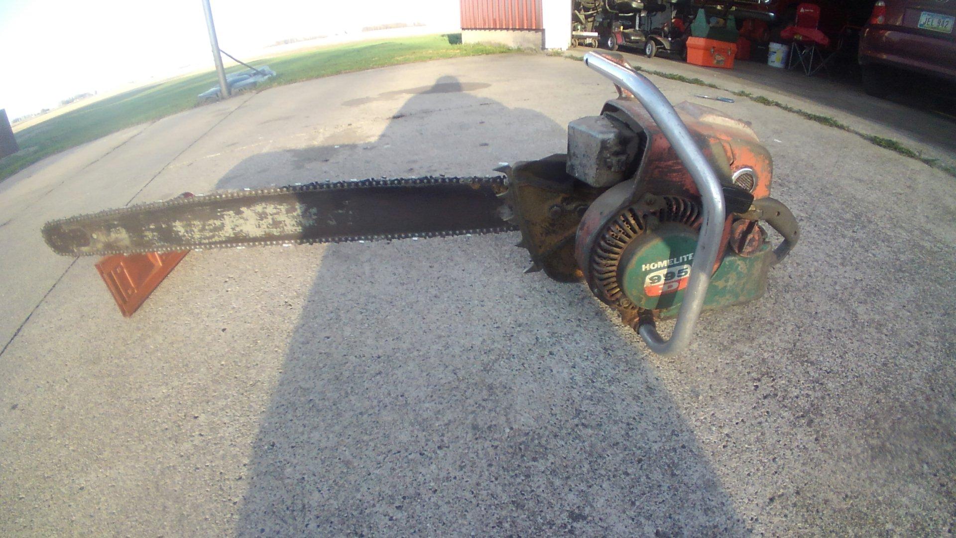

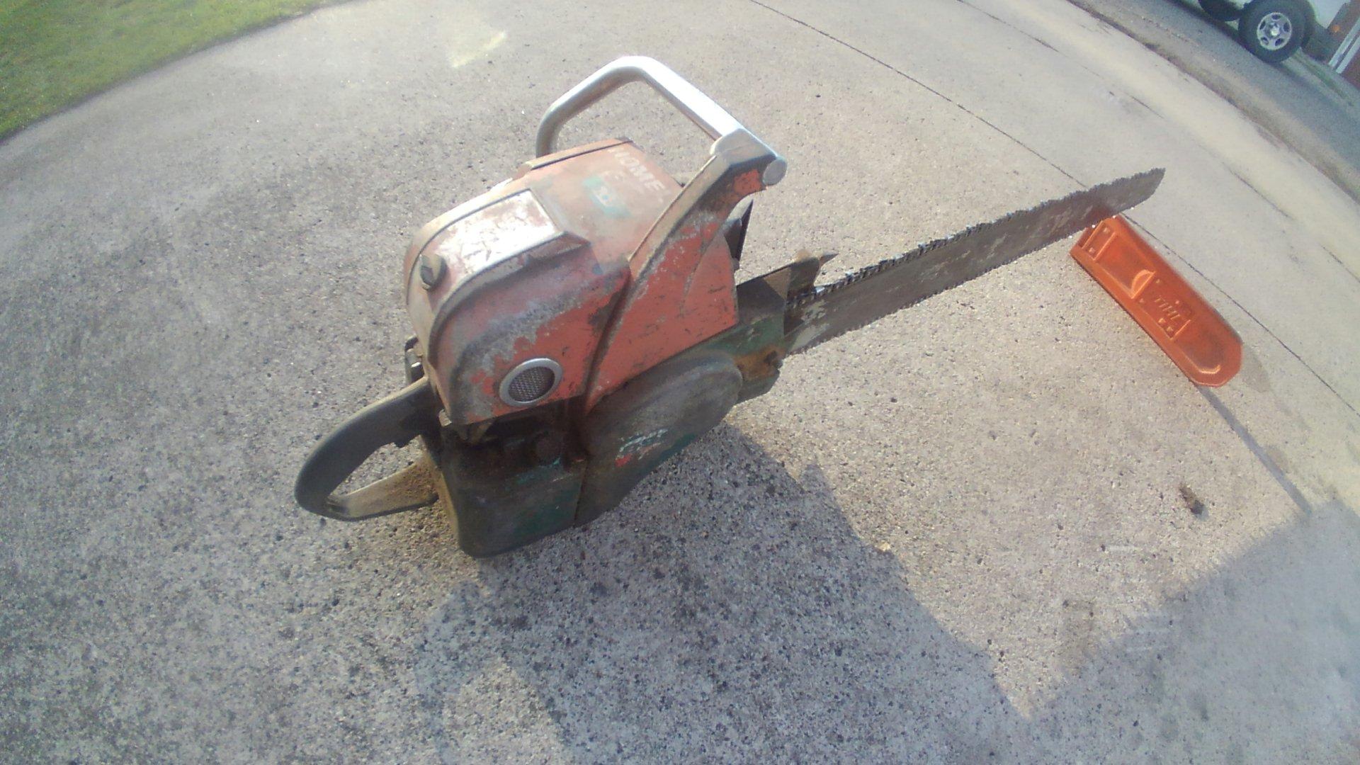

I just bought this model 500 & got it delivered today.It's missing the drivecase cover,bar plates,& tensioner.The seller never said anything about those parts missing or showed a pic of that side of the saw.I think the Buz chainsaw took the same parts,so there may be hope that I'll get this saw operational before I die.

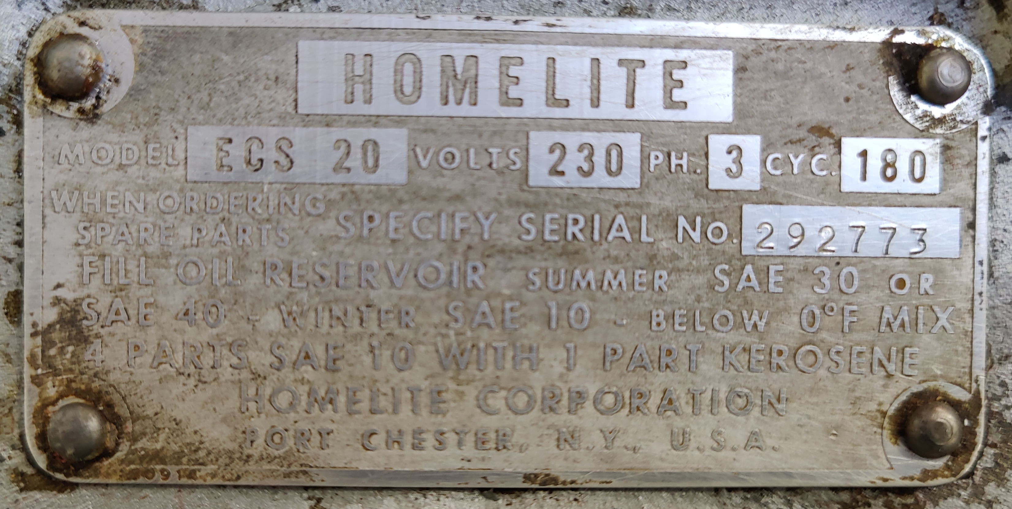

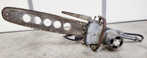

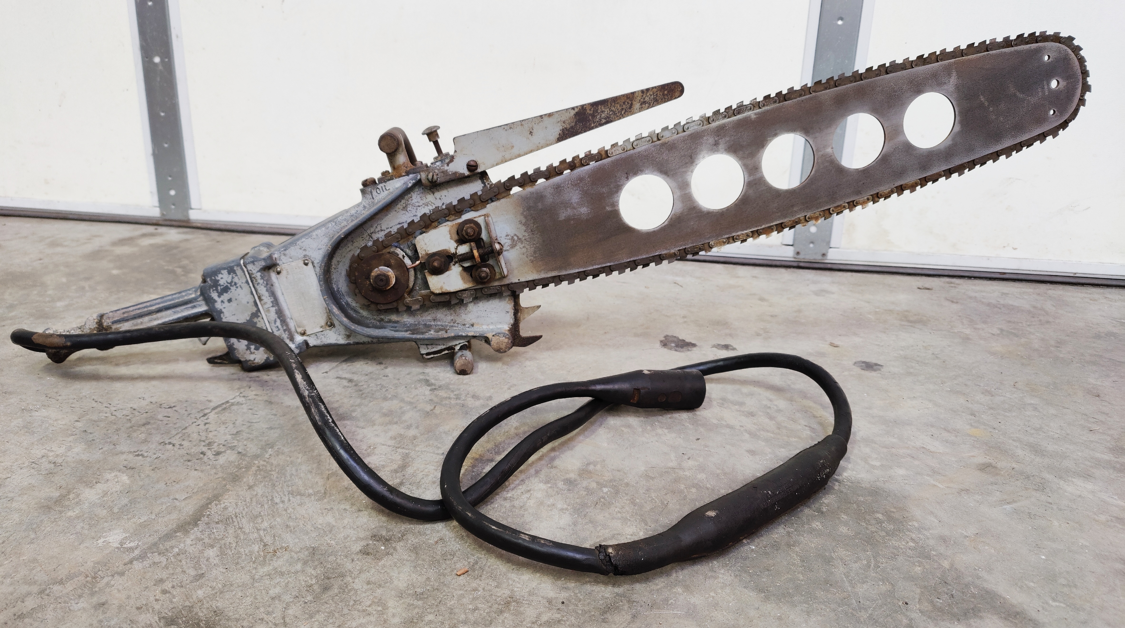

I had a friend send me a marketplace listing for this ECS. I have been looking for one for quite some time as I've got the generator that powers it. 230 volt 3 phase 160 cycle. It's the first chainsaw model that Homelite manufactured.
Sent from my LE2117 using Tapatalk
That reminds me of my Stihl E30. A fairly compact powerhead that weighs an incredible 48 lbs.
