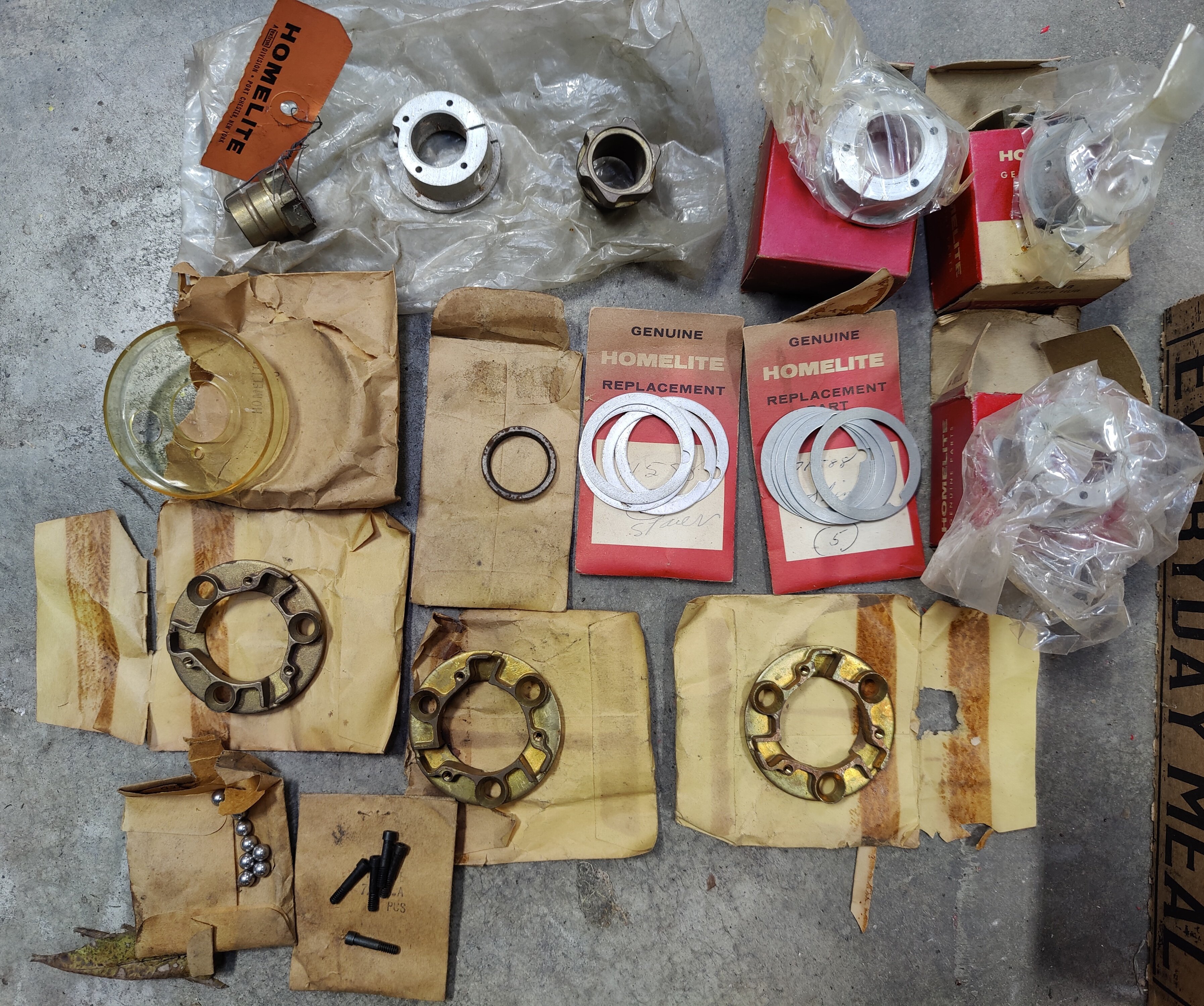

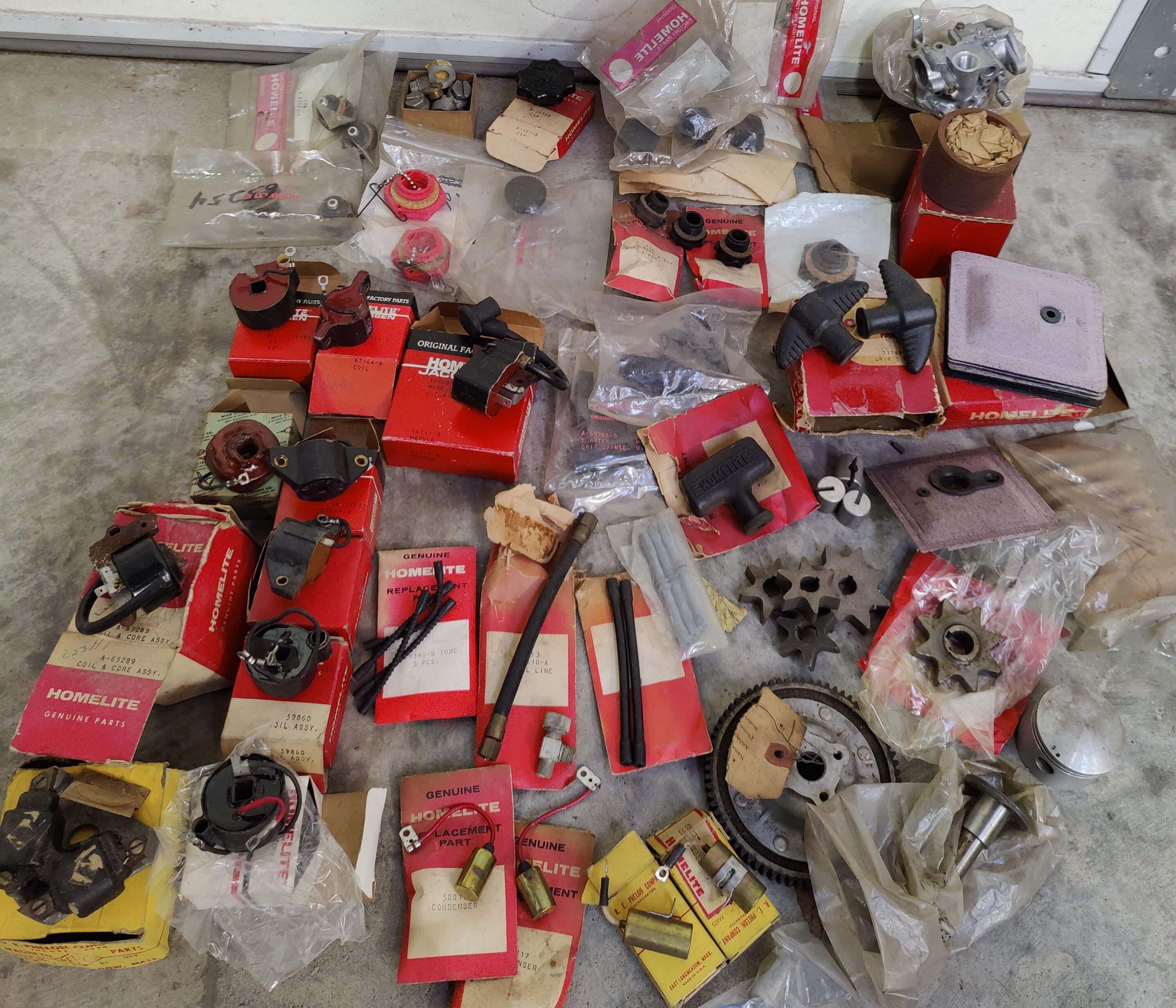

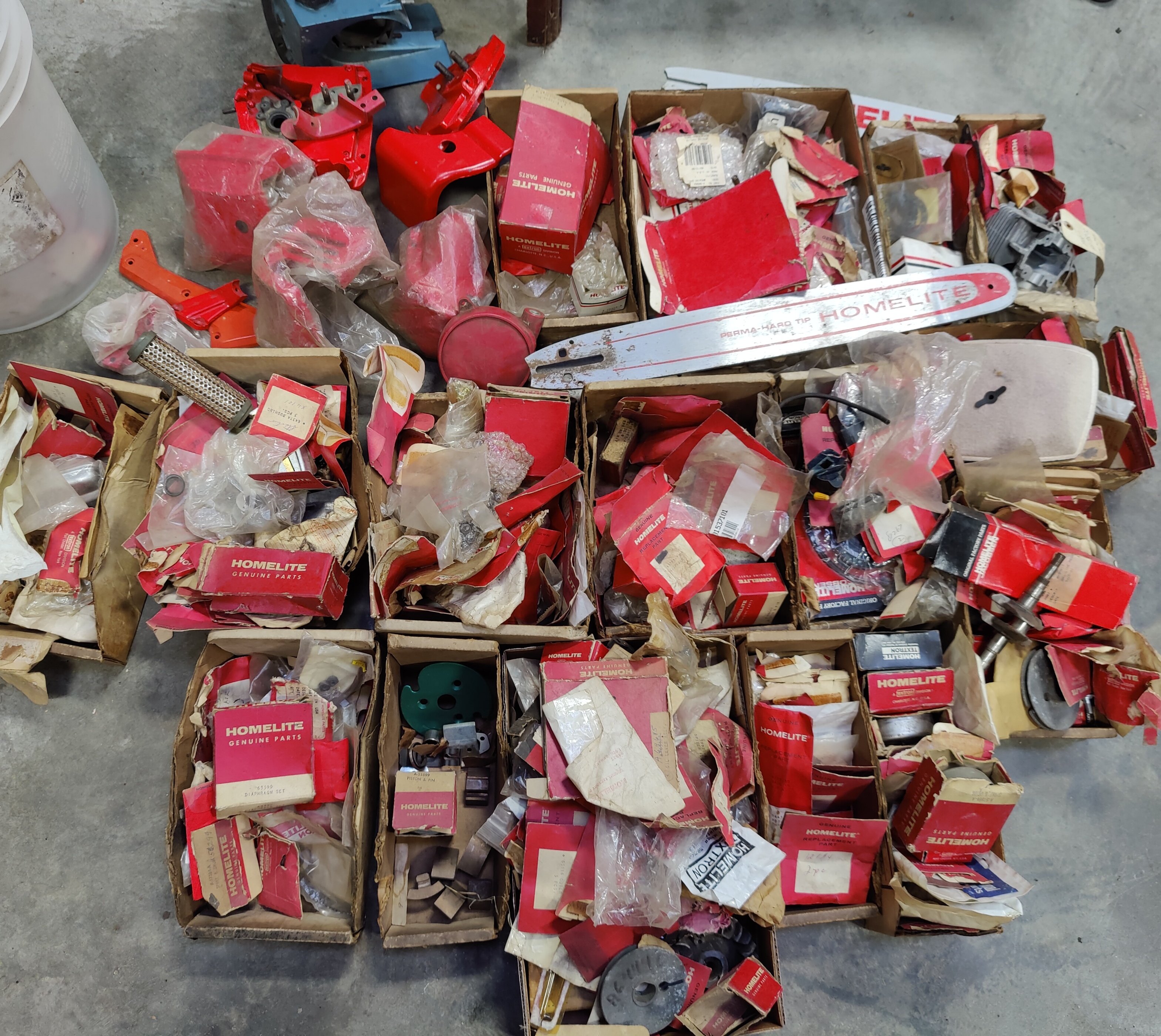

Got a few more parts in the last few weeks to add to my inventory. Without these included, I've got over 1600 NOS Homelite chainsaw part numbers. I sell very little as I'm still collecting saws and draw parts frequently for repairs.

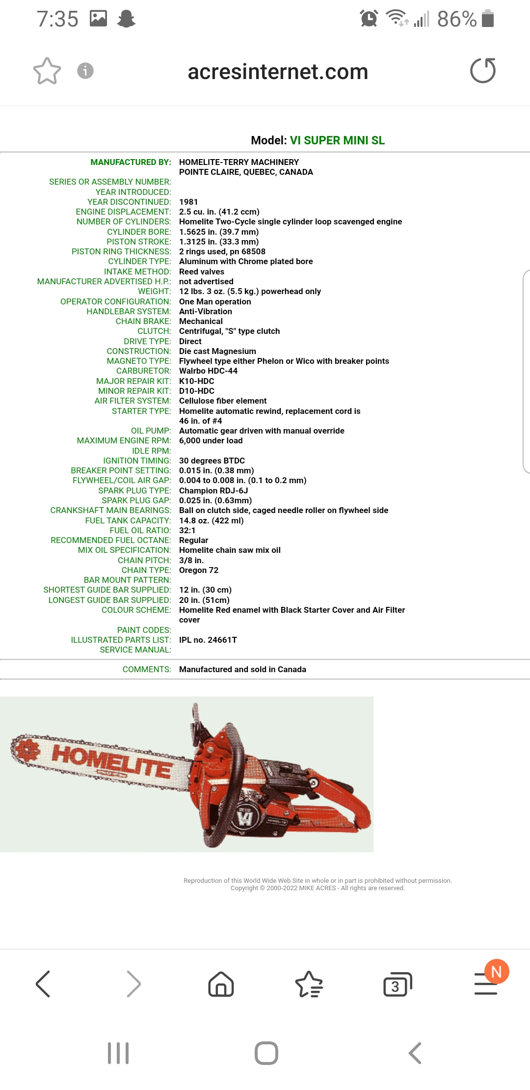

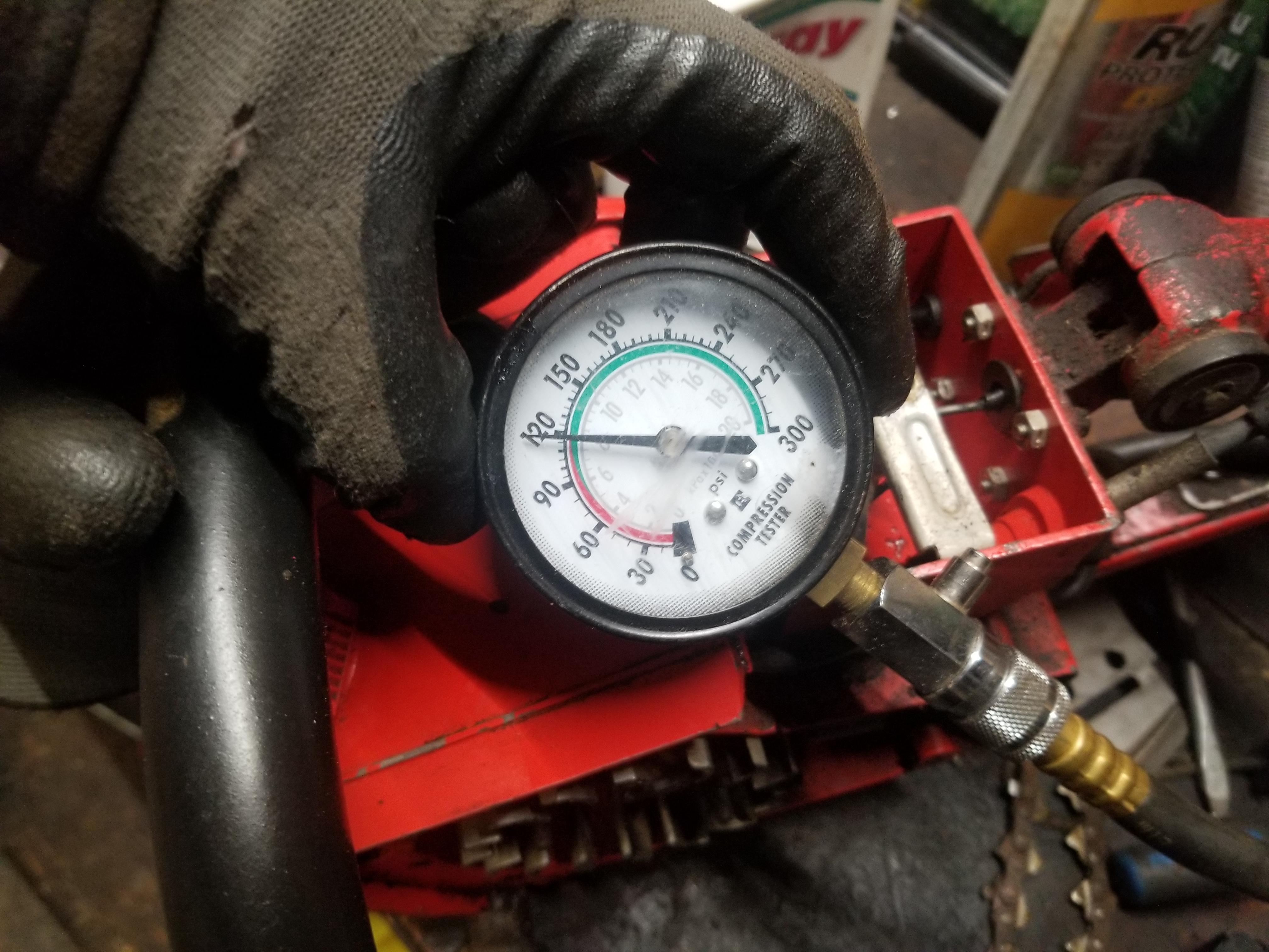

What is good compression for homelite saw? Working on a super mini vI that i thought would pop with little fuel down the carb but nothing. It has 120psi. I always went by 130 was low but i inow some of these older saws are little lower then normal.
I also dont have the proper spark plug and was only able to get it half as s tight which would have been even less but i figued i would at least get a pop of some sort.
It has lots of spark.

In my experience, 120 psi is what alot of cheaper machines have when new so that should be enough to run. I would get the right plug before you did anything else, you might be leaking just enough not to start.

The manual says comp should be 155 - 185 psi.
Check the decomp valve to make sure there's no carbon holding it open.
I would think you should get a pop out of it at 120.

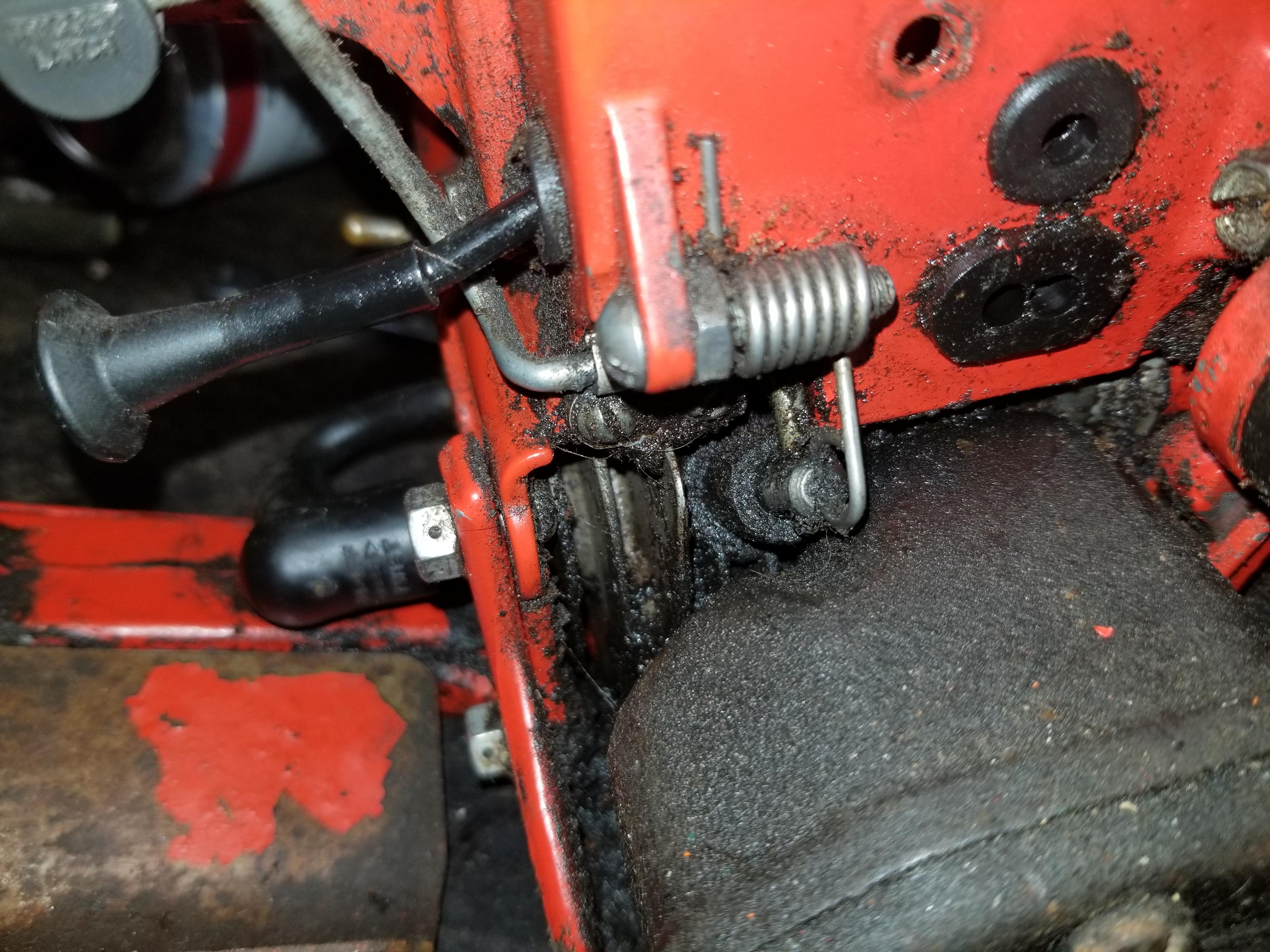

So back at the little mini. I got the proper plug and pull cord fixed. Put a carb kit in it and git it running. It accually runs pretty good. But now i got a broken clutch. I found a couple used on ebay but the shipping is same price as the clutch. Will maybe check at the saw shop to see if he has any in his used parts area.
Any one know what other modle saws will have the same clutch?
This saw does have the decomp
Same as some mini's some EZ's and Xl-1 saws.
Your clutch drum looks thin as well but that may just be the pic.
I'll send you a PM regarding an Ontario contact on FB.

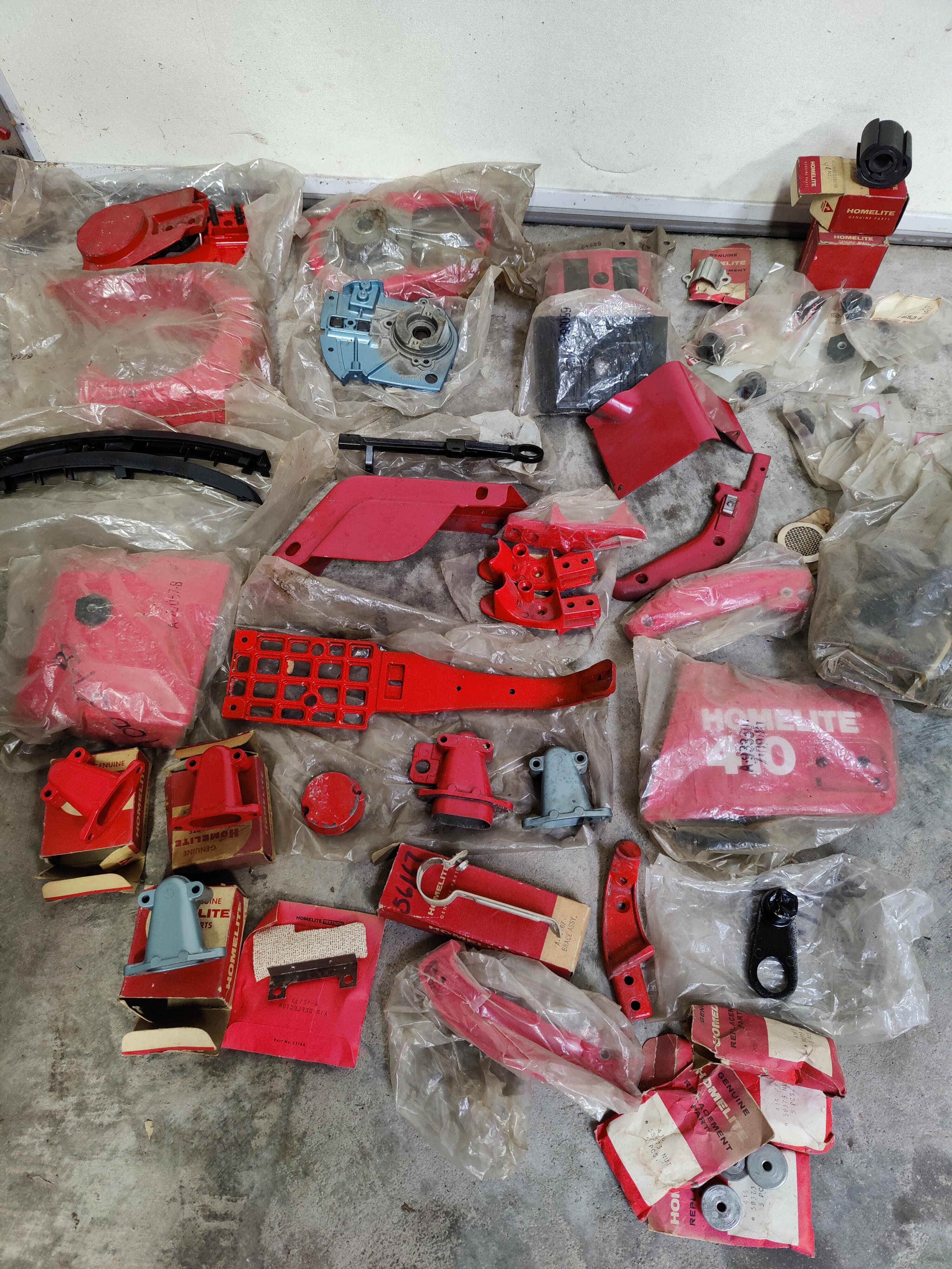

I have a old 410 homie. I think I have all the parts to put it back together if I can find them. Is it worth it? Think it's 68cc, probably slow and heavy.
