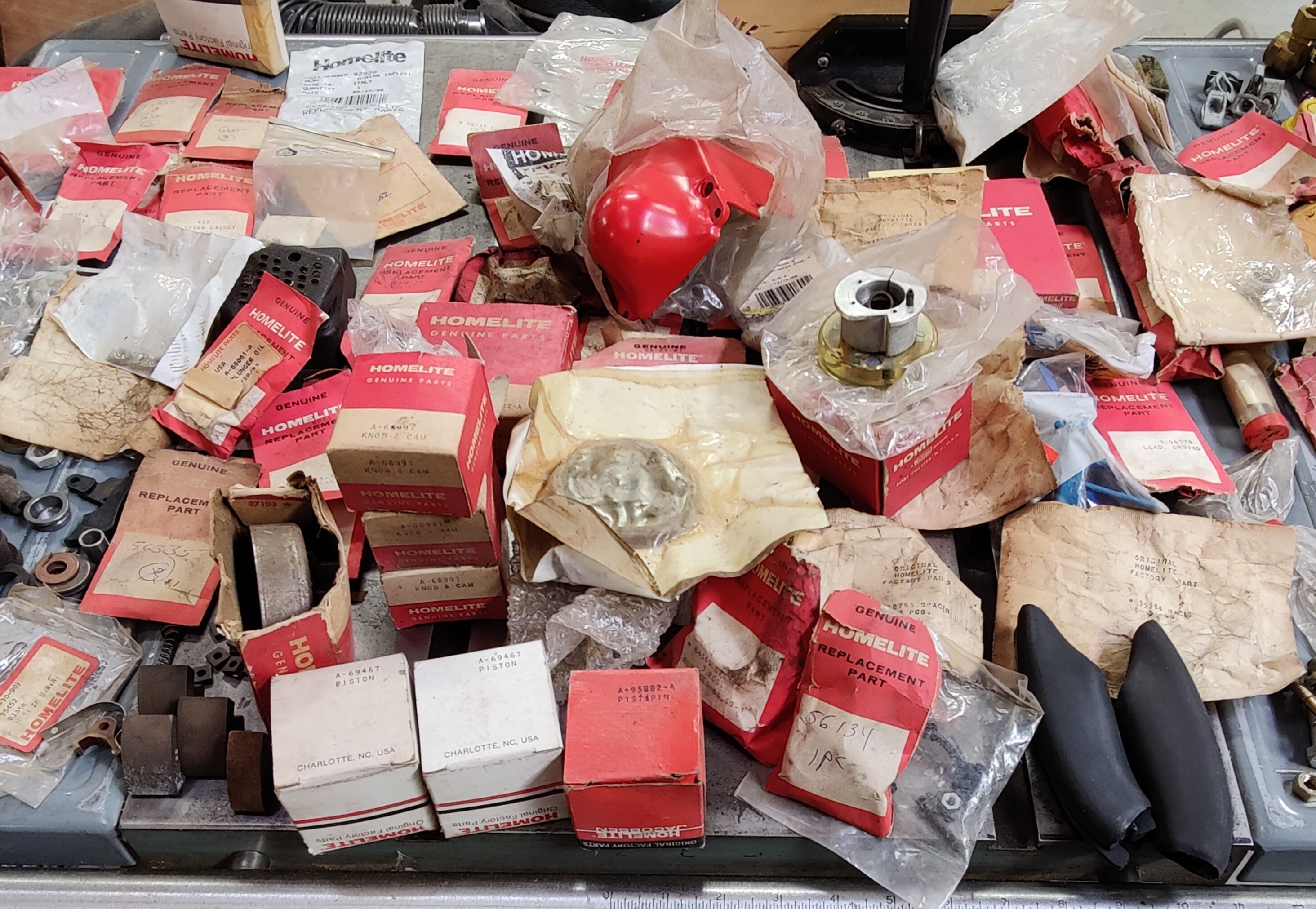

Going through a pile of parts I picked up recently and found a hen's tooth. A NOS sprocket for an XL-15 gear drive
Sent from my LE2117 using Tapatalk
