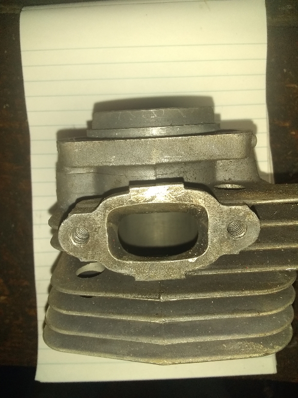

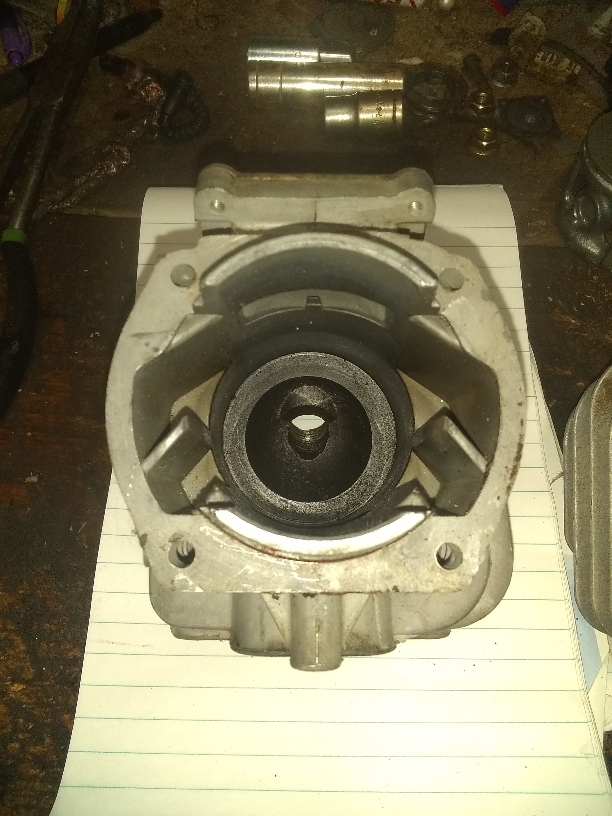

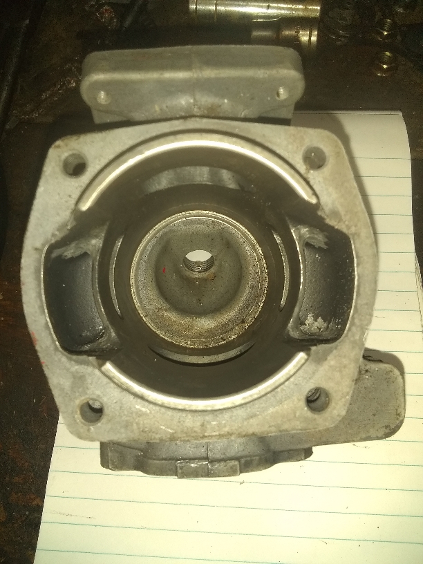

I also have a question about this mess of 8800 stuff i was given the guy my buddy got them from had a bunch of modded 650's 750's and he was given these cylinders with another modded 8800. Both have the same bore but the muffler mount holes are different on one of them so i wondered if they were actually both from the 8800. One has been ported the other is unmolested...intakes are different shapes and the Transfers and piston skirt sizes and shapes differ as well as thin/thick ring pistons are obvious...he does also have about 30 more if these nos thick rings with the mess...

Those might be 540 cylinders also, the 540 had an early design and a late model right before the 8800 that was redesigned to reduce overheating.

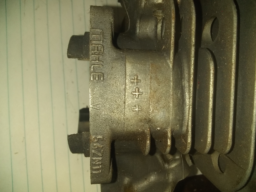

Probably hard to cross reference but here is one of the numbers....

Found one of my homelite books and this is what i found.....anybody know what the letters at the end designated? That's the only difference i can see....

The numbers on the end are usually a revision number, I looked in my service bulletins but I can’t find the 540 cylinder information,

The letters on the end are indeed revisions but normally all the letters interchange with each other. There are a couple of exceptions which were mentioned on the House of Homelite a week or so ago. I don't remember exactly what they were and I cannot find the thread just now. Onlyhomelites, Leon, knows which specific parts would be involved.

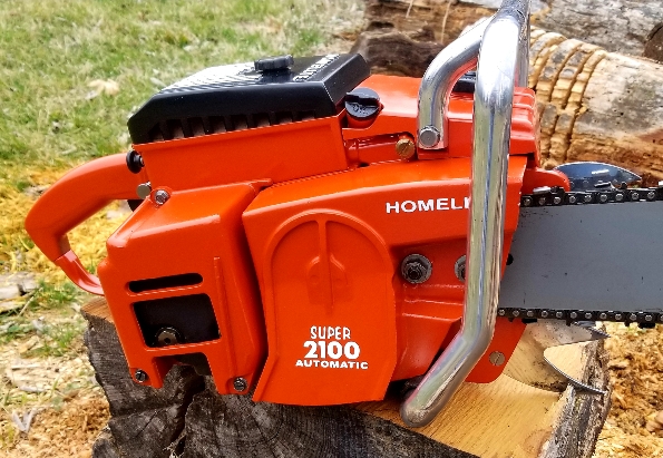

PogoInTheWoods
9:18 AM
1190
Apr 23, 2016
1,957
3,908
Ohio
So that's what one of those is supposed to look like! LOL
Another magnificent job.
