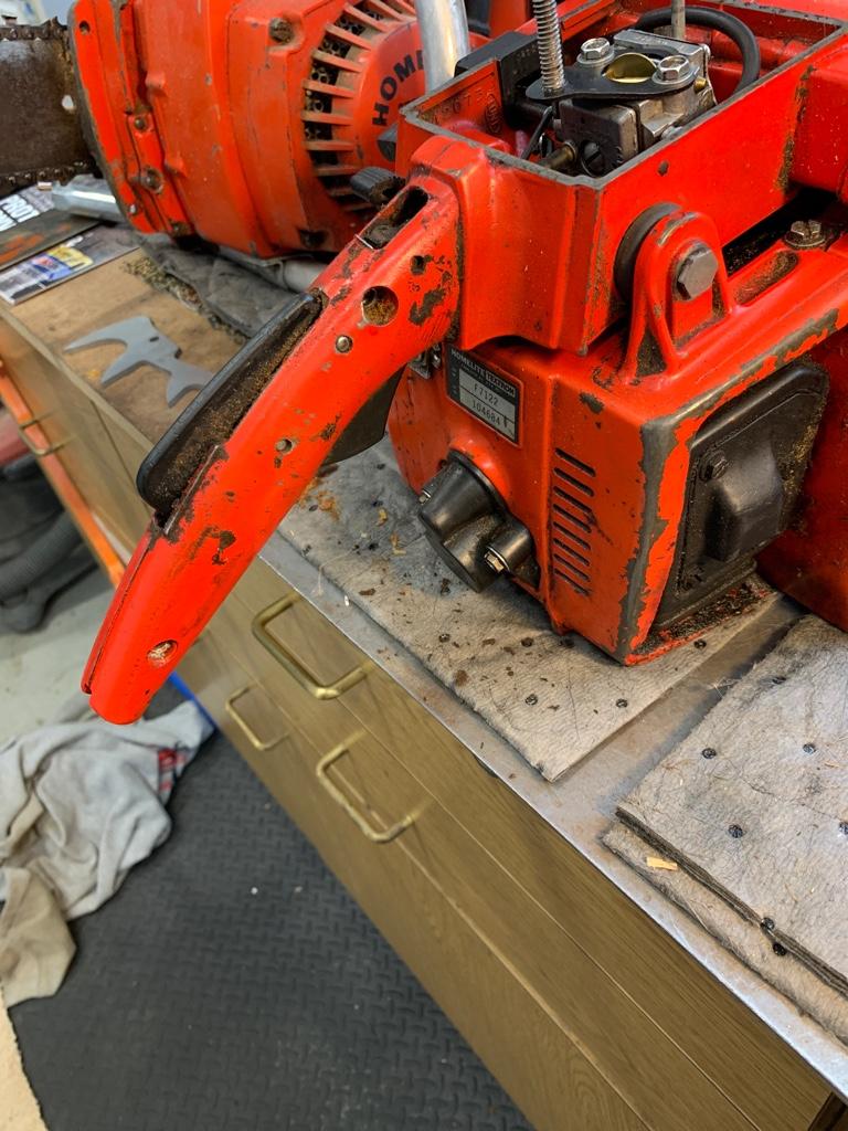

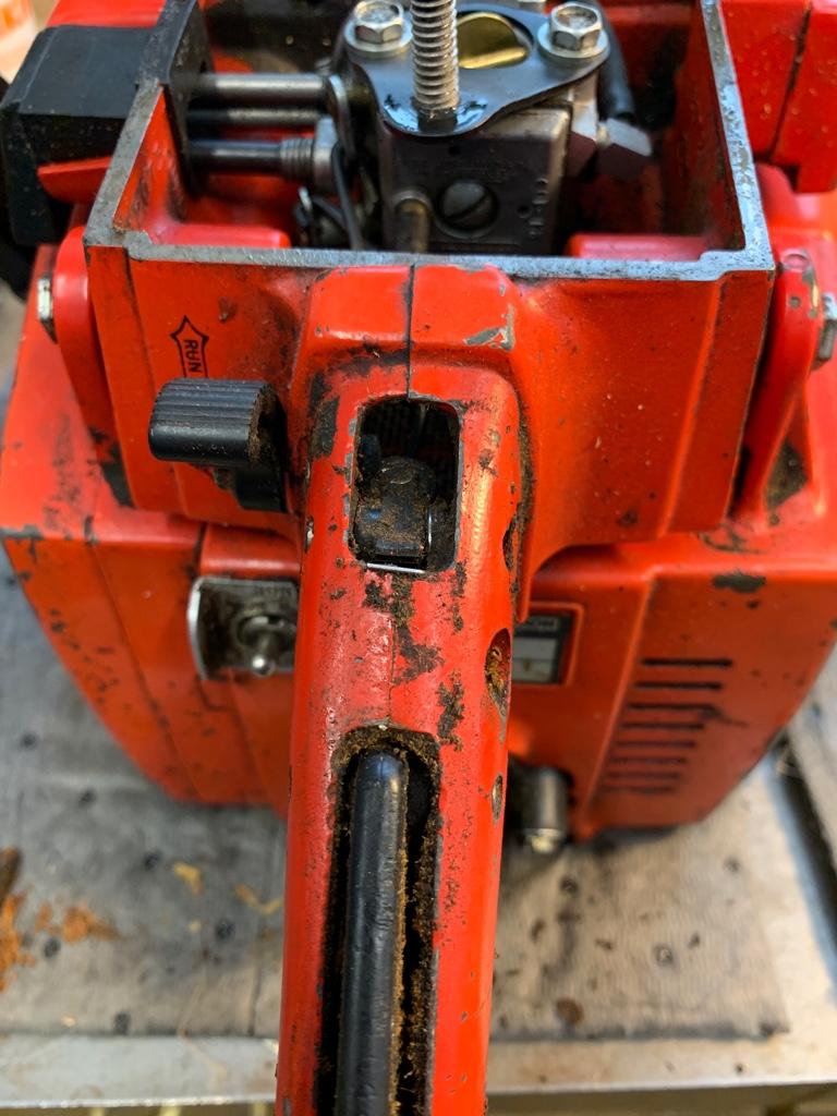

Ok guys. Working on a couple Homies today. Not familiar with the saws all the way around yet.I have a good running 360 with the throttle lock broke. I have a donor saw I can swap one out wondering what the best way to get in the handle is? it looks like it’s into pieces until it gets to the carb housing.. or do I just punch the pin out?
fossil
12:14 PM
374
1,905
8,880
Ontario, Canada
Looks like the pins need to come out. Link to an IPL

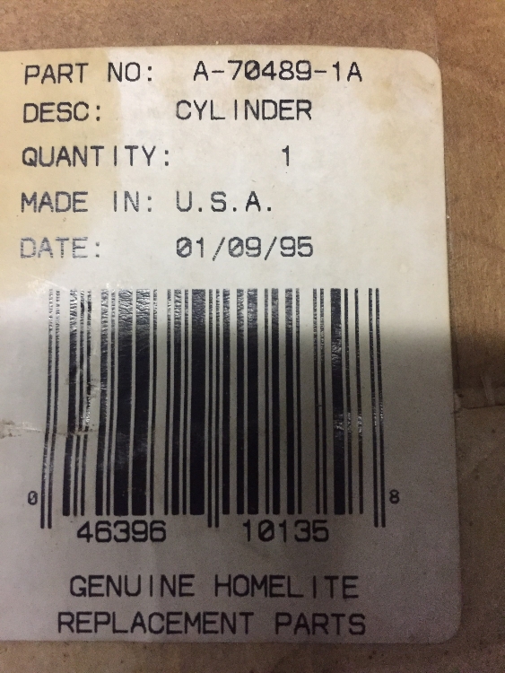

Looking for id on this one boys. I was told it fits a 750 but not certain. I cant find my old ipls for this series of saws....thanks for any input!
