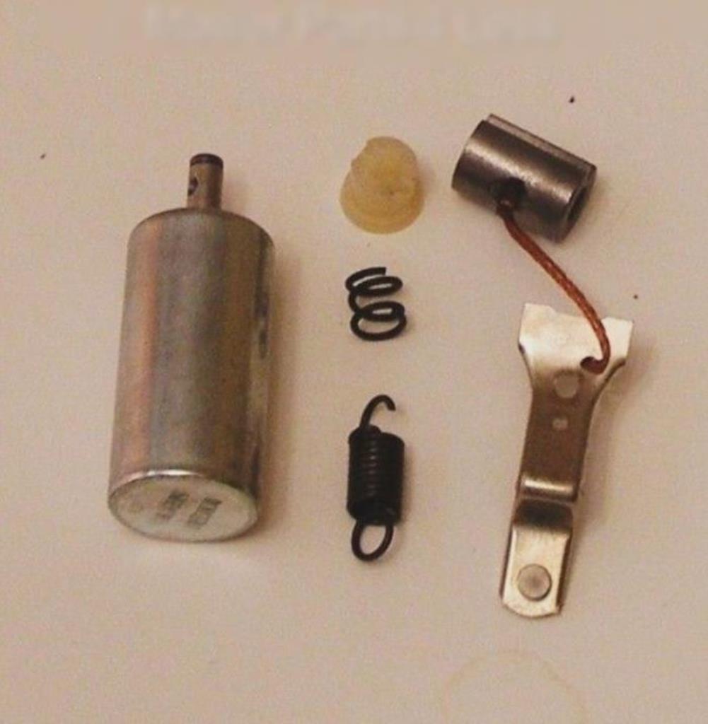

That thing looks kind of like a Briggs and Stratton condenser except the Briggs uses a coil spring to hold the wire .

spring on homelite points goes to post, too.
lil screw in end.
put it all together thinkin shelf queen fer a while.
then remembered got a nova, sittin, waitin fer somethin like this...
would stihl prefer point setup tho.

FWIW any condenser that could be fit in the space provided and connected will work on a magneto type of ignition system .Unlike a battery spark where a mismatch of microfarad rating will cause the points burning on one side or the other ,it's only function in life is to stop the points from flashing over .In effect it acts like pressure tank on a water system .
