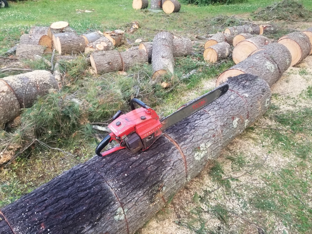

Update on the Super EZ auto I got from my nephew.
Just needed a good cleaning out. Lots of crud in there. Blew out the nasty air filter and had to retune the carb.:)
He Also had the bar spacers reversed, and only one has an oil passage, so oiler problem solved.;)
Tested on some cedar out in the pile. Its a hungry little thing! Lots of grunt for its size.
Giving it to Dad for his birthday this weekend. He has an EZ auto that doesnt oil right and has an air leak. Rather, im trading him so I can fix his. May or may not give it back.:D
He loves that saw, im guessing because of the power to weight thing.1022191554_HDR.jpg 1022191554.jpg
