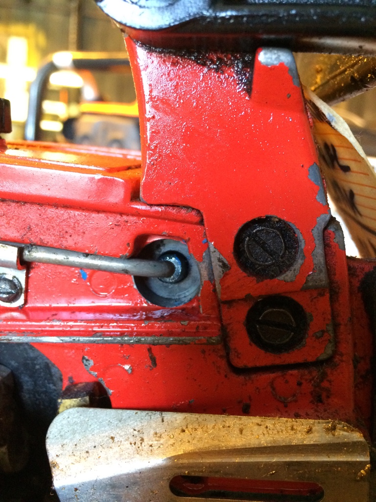

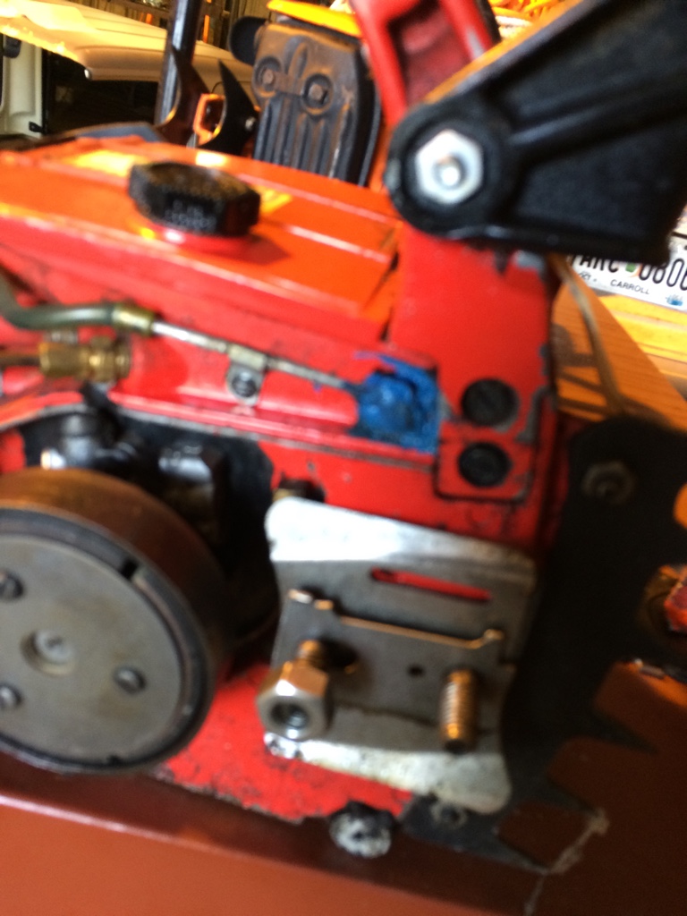

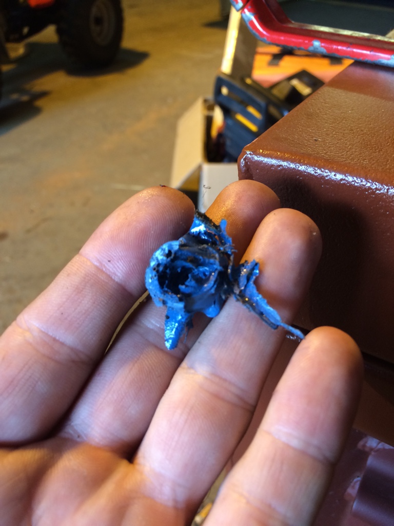

Ok guys, need some help. I have two Super XL 130's. The first one
got a few years ago and had no spark. So i found a coil on ebay but
it didn't match the one on the saw. The new one was blue, one on saw
is black. So i sold the blue coil to a member and now i own that saw.
So i finally found a black coil that from what i could tell should be the
correct coil. Wrong. This black coil has the lead that would go to the
points. Mine is electronic. So now i'm thinking the black coil must have
been installed by who knows who. And is incorrect. I'm thinking i need
the blue coil after all. But i can't seem to find the correct IPL for these
Super XL 130's. So i need the correct part number for the blue coil.
TIA
