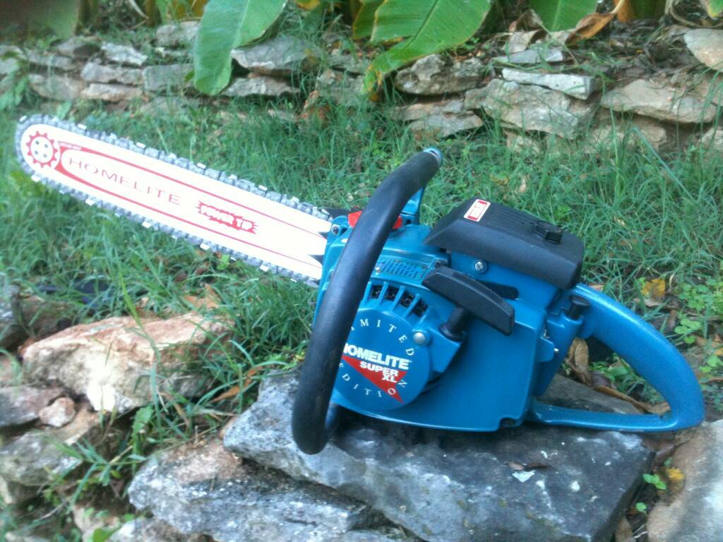

Was missing a fuel filter and spark plug.
Then I had to put gas in it and pull the cord.
Haven't tried it in wood yet.
Do they have a governor?

nope but i recommend you check out the intake boot most are bad on those anymore.

Yeah. Them is a problem. But that's the way it goes in there.
Shove in the tube after the grommet part if the pickup hose is in place.
If that's from little red barn, watch the end if it splits from the supplied filter. BTDT

Nope,nos Homelite.

Use lots of silicone grease or something slippery and work in in slowly. Sometimes pushing with something blunt like a popsicle stick is easier (and less likely to break it) than trying to pull it through.
