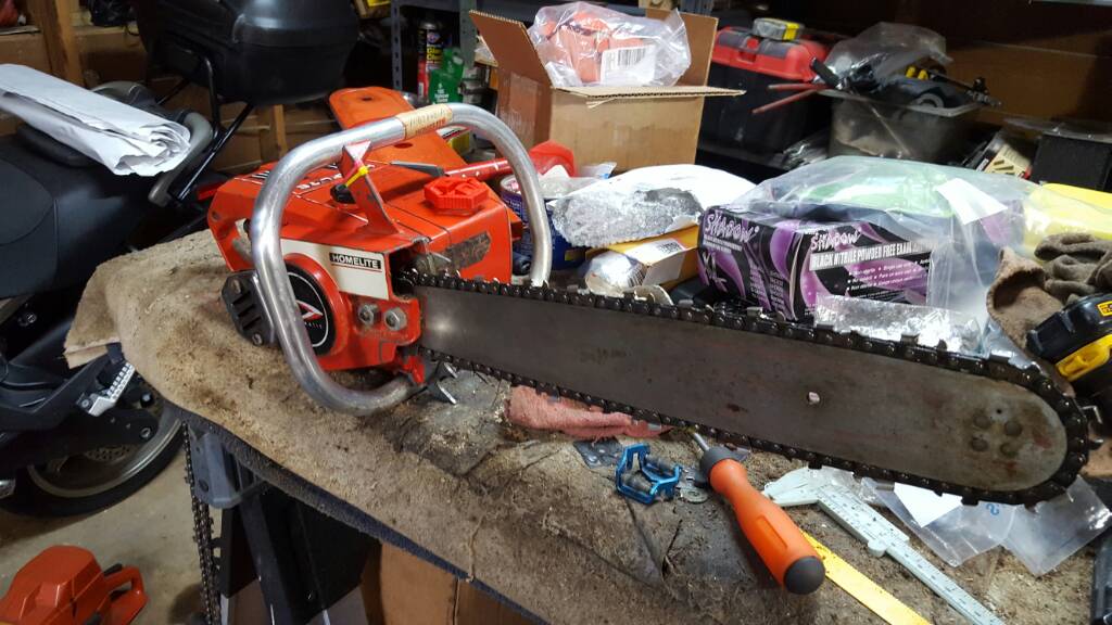

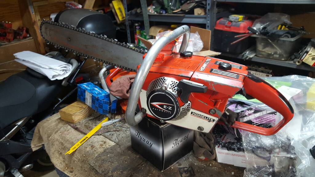

This followed me home today. Looks to be very well taken care of. Former owner says that it starts and runs fine . . . for awhile, then stops. Won't re-start unless it is completely cooled down. Sound familiar to anyone? Coil? Condenser? . . . . .
Homelite Super Mini S Automatic. Model number is UT 10546. Made in Canada. This one has a chain brake and vibration mounts. Some posts in other forums suggest that this is similar to the Super EZ Auto?
Thanks!

Yes it's basically a SEZ with anti vibe. It probably has the notorious blue prestolite coil?

Thanks. I have not opened it up yet - not sure when I will get a chance. Wanted to find out if this is a common problem, if parts are available. etc., before I got too invested in it.

Those blue coils are available, but they've been trouble prone since new. Pioneer used them too.
It could be converted to points
