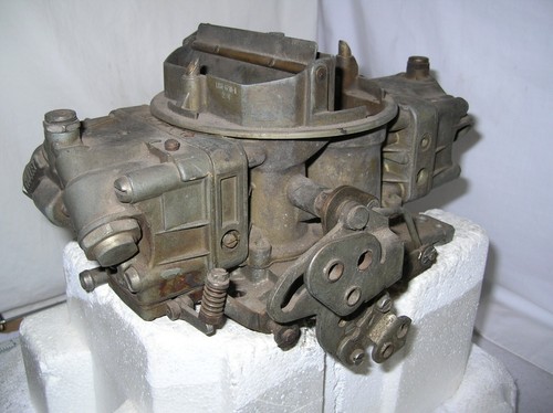

I bought a old spread bore Holley off of Ebay recently. It turned out to be a Frankencarb.
4165/6210 carb was a 650 cfm double pumper q-jet replacement carb. That carb came equipped with a single inlet that matches the q-jet's location. It also has side hung float bowls.
The 4175/6213 was a 800 cfm double pumper, dual inlet with center hung bowls.
I was hoping that someone used the 6213 bowls on this carb....but that wasn't the case. They used the bowls from a 4150.
The accelerator pump passages are in a different location on the spread bore carbs, so the 4150 bowls don't line up, and dump the pump shot back into the bowl. I imagine that the person who bolted this thing together initially was frustrated. LOL
Holley did make a kit years ago to convert the carb....but its NLA. So I spent a few days thinking about it, and decided to make a couple of brass plugs to plug, and relocate the passages.
After a nice bath, and a kit.
