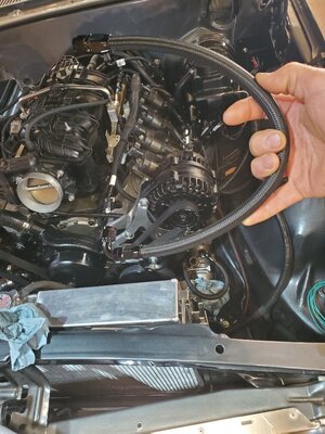

Power steering pressure hose take 2
Those truck intakes actually work really well. They make decent HP and torque down low and flow quite well up to 7k rpms. I’ve seen pictures of the truck intakes where guys have shaved and painted them and they actually look decent. Finding a good TBSS intake would be awesome followed by an ls1/ls6 intake for an oem performance intake.
