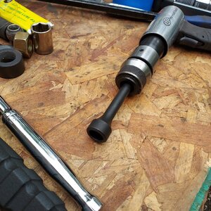

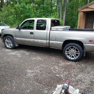

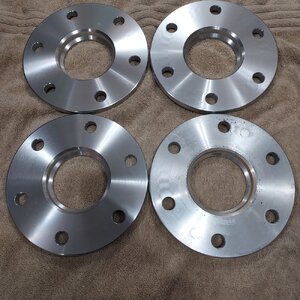

Well no computer bs here today. Just 22" Yukon wheels, 3/8 wheel spacers and longer studs. I will say that a 5/8 ground rod driver in the air hammer is a very effective wheel stud remover. Yes a hammer does the same thing but my luck I'd swing, miss the stud and take out the break line. I wanted 20" wheels but these popped up in Erie, PA for a good deal so i settled and took a little road trip

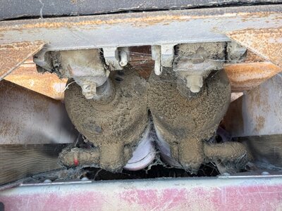

Yall northerners rust still shocks me a little 😆
I’m not a big wheels guy but that’s pretty clean
Now when they start putting lo pro mud tires on “14 wides” (whatever the flip that is supposed to mean) on 4x4 diesels…nah. Too far from function.

We have tons of them diesel dans running around with $8k in wheels/tires with the rubber band mud tires and the wheels that stick out 10ft. Rust and vehicles is definitely a never ending battle here. I just fluid film everything every October and that helps alot

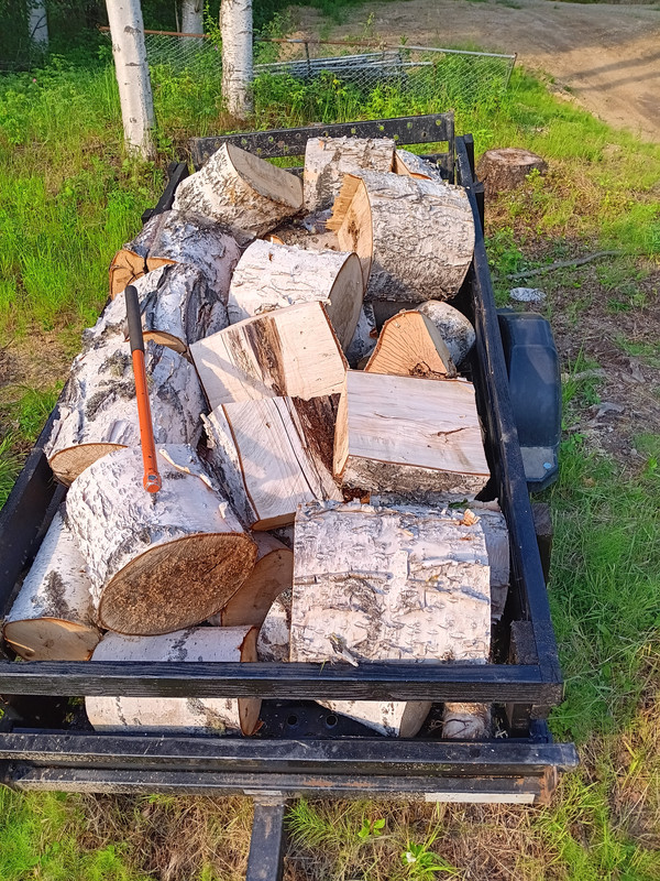

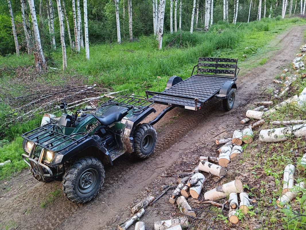

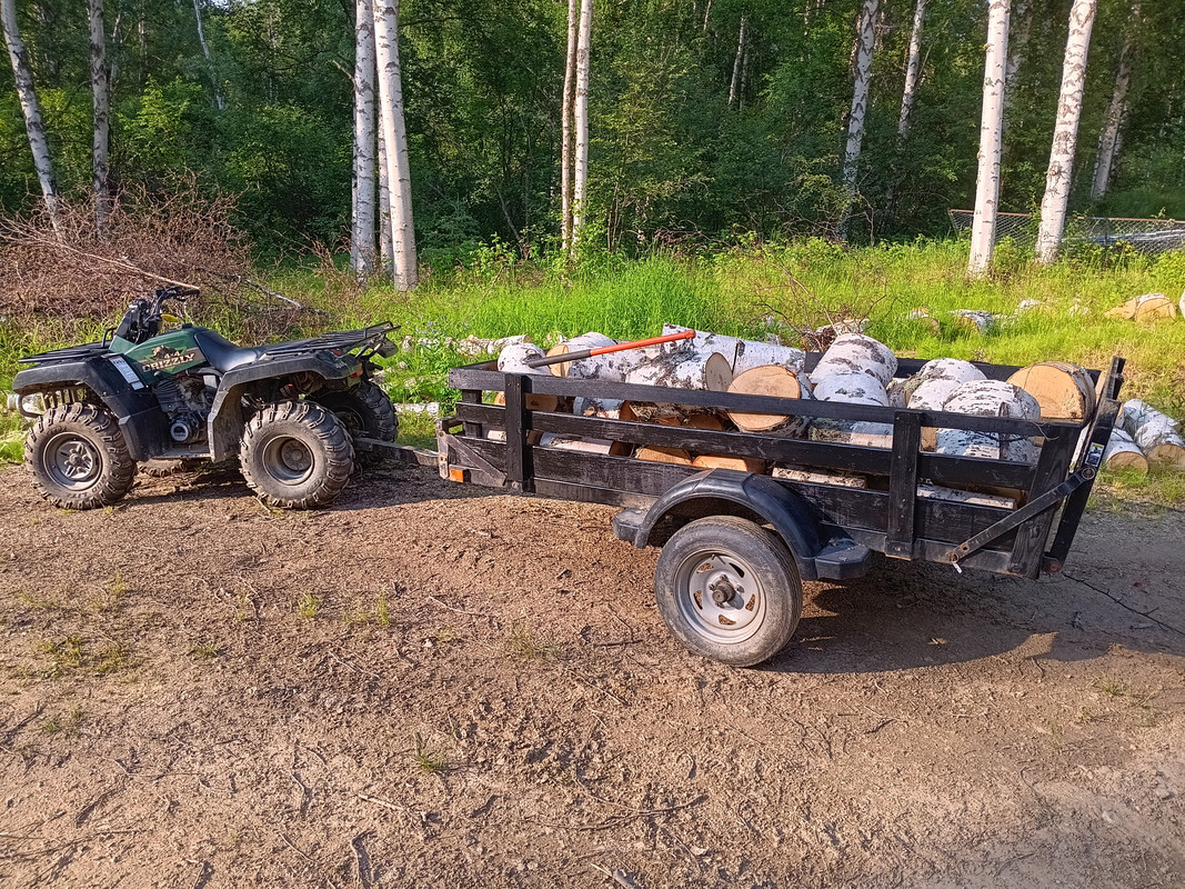

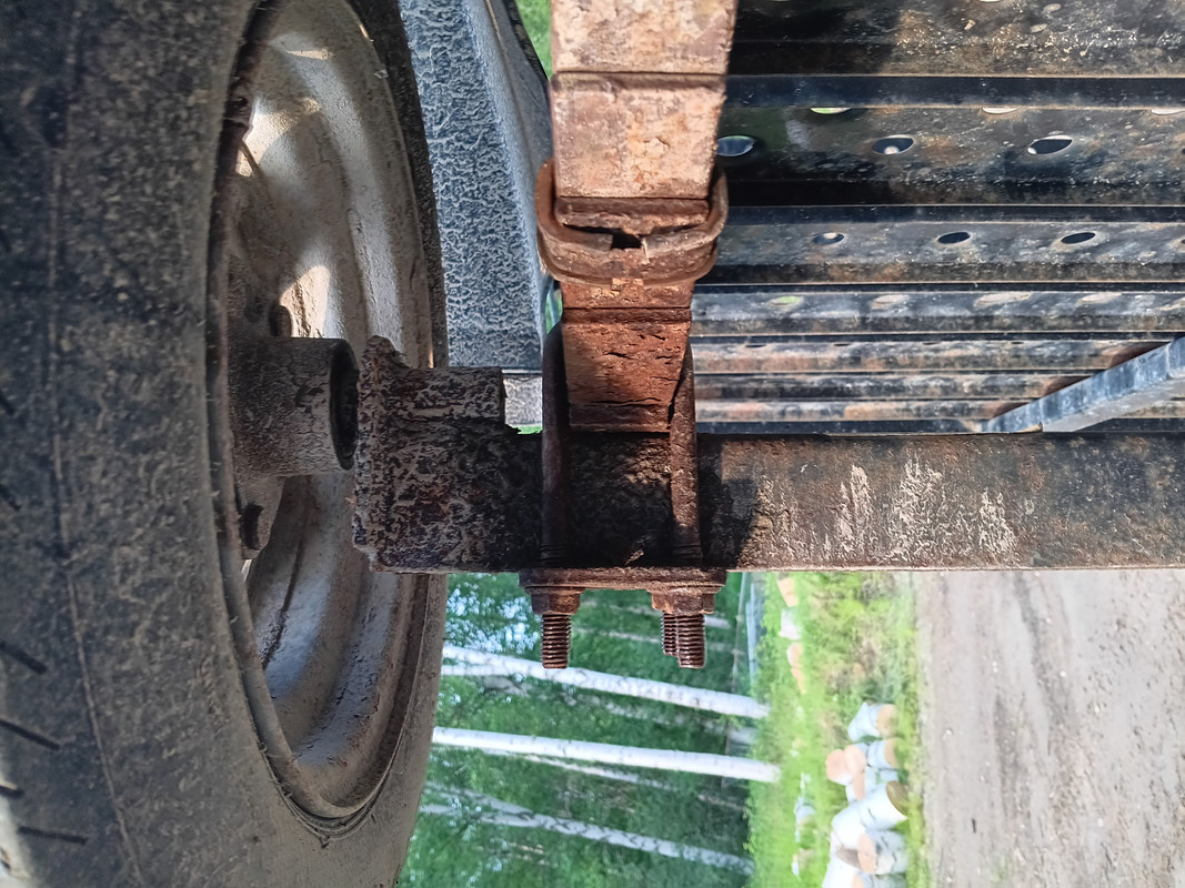

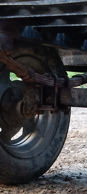

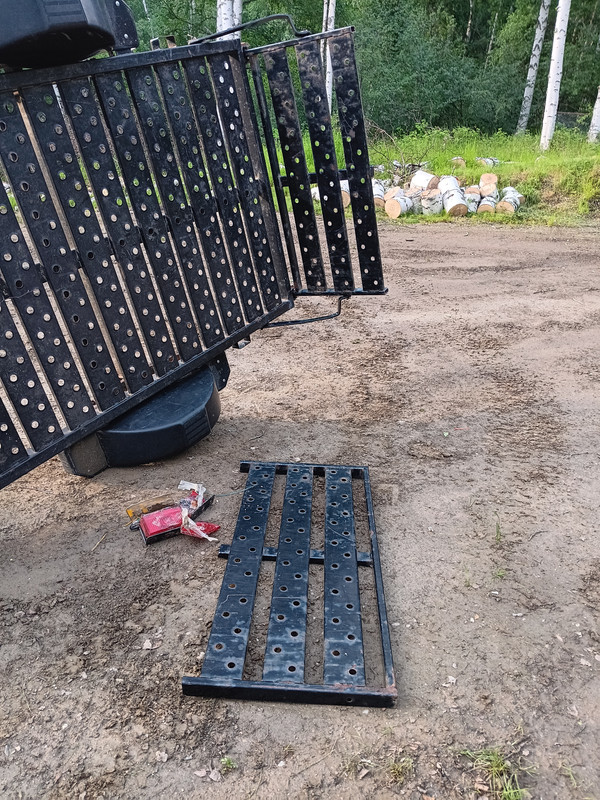

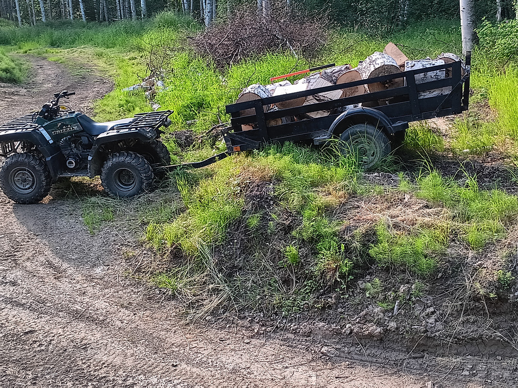

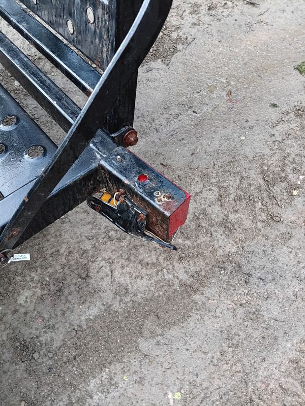

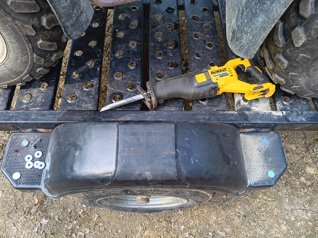

Modified a small road trailer to an atv trailer. I'm in disbelief how expensive atv trailers are here in Alaska. Screw that.
Flipped the axle for more ground clearance. Trimmed the axle bolts. Cut and tucked the fenderwells. Trimmed the loading ramp into a tailgate. Cut off the steel brake light brackets. Flipped the tounge to get the trailer level for ATV's. Cut off all the wiring. Removed the trailer jack.
Just gotta build wooden sides.

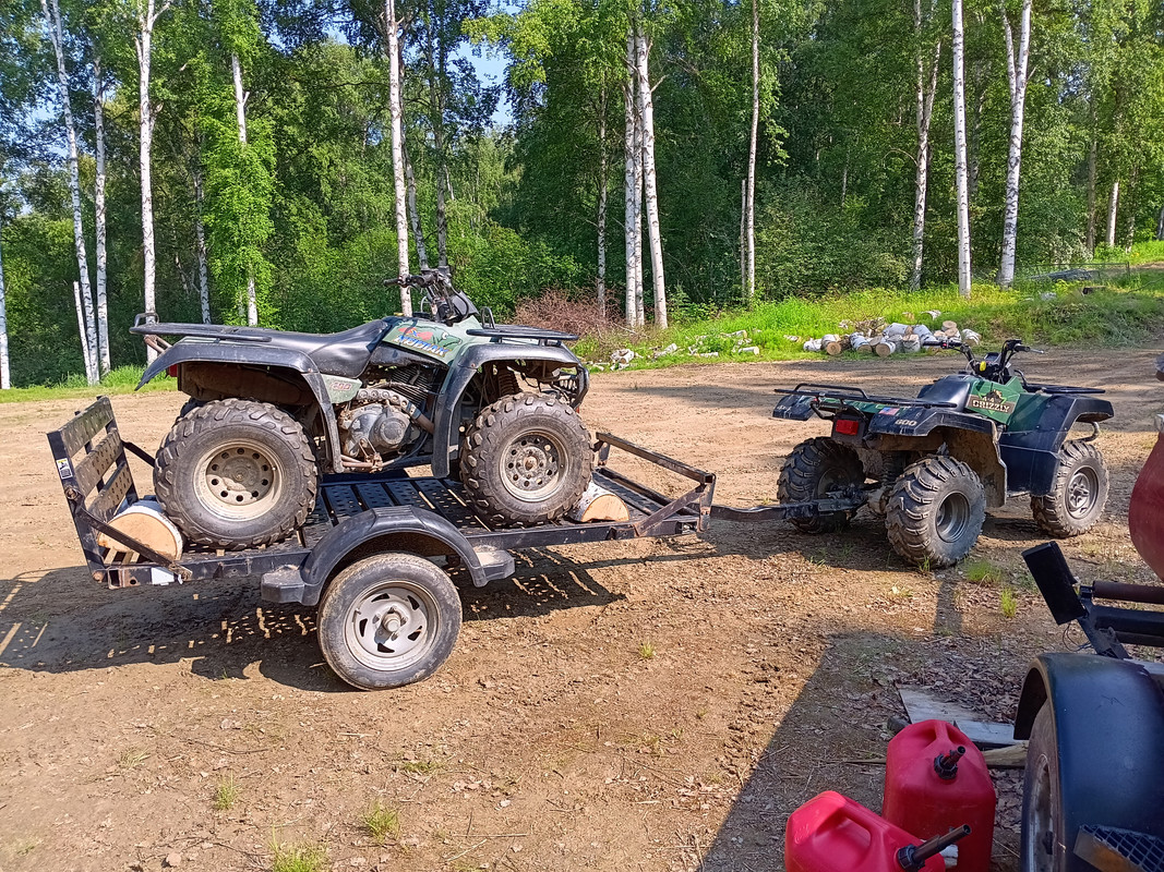

Working purdy good. Though definitely at the limitation of the brakes going down a steep hill. Used 4 low and didn't smell any burning clutch belt. The oil cooler fan turned on, she got hot! Air cooled motor, so running 5w-50 lucas atv/utv oil.

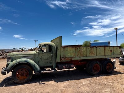

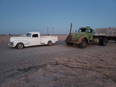

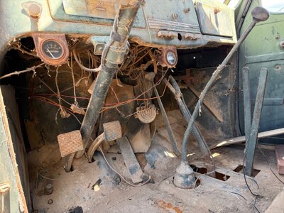

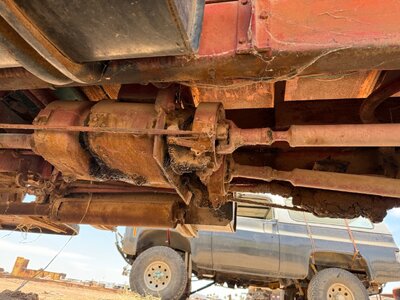

Heck yeah! Behind my old shop, there was an old international medium duty truck with a 501 cubic inch red diamond gas engine.
Always thought that would be a viable alternative to the garbage diesels presently offered. An entire engine rebuild would cost less than a single diesel injector.
The red diamond engines really aren't obsolete. They could be used if somebody was willing to test things.
Nor is a 292 chevy or 300 ford obsolete and they were in production around the same time as the big block international inline 6's.
